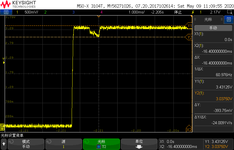

When the terminal product is working,timing sequence of Chip pow er input port  is abnormal.

    TPS65131-Q1 has a soft-start on both boost and inverting converters that is place for about 1ms and from your scope plot, it appears that input supply sags ~1ms after it ramps up. So I think your input supply is not able to support enough current after the soft-start time of TPS65131-Q1 perhaps due to excessive inductance/resistance in the input supply path or not enough capacitance at the input supply pins of TPS65131-Q1. You can add more capacitance (10uF?) at the input supply close to TPS65131 and that may improve the sag you are seeing.

       The countermeasure you provided has no effect.Does the input port of this chip power up with the current limiting Irish specification?At present, we have measured 1.3A Irush.
    As I mentioned earlier, both boost and inverting converters have a soft-start that last for approximately 1ms after being enabled. After this time, full current limit is in effect. One more thing you can do is to not enable both boost and inverting converters at the same time. Instead stagger them so that one is enabled first and reaches regulation before the second converter is enabled. This will reduce the input supply current demand. Beyond this, input supply needs to be able to provide enough current so that it does not sag.
