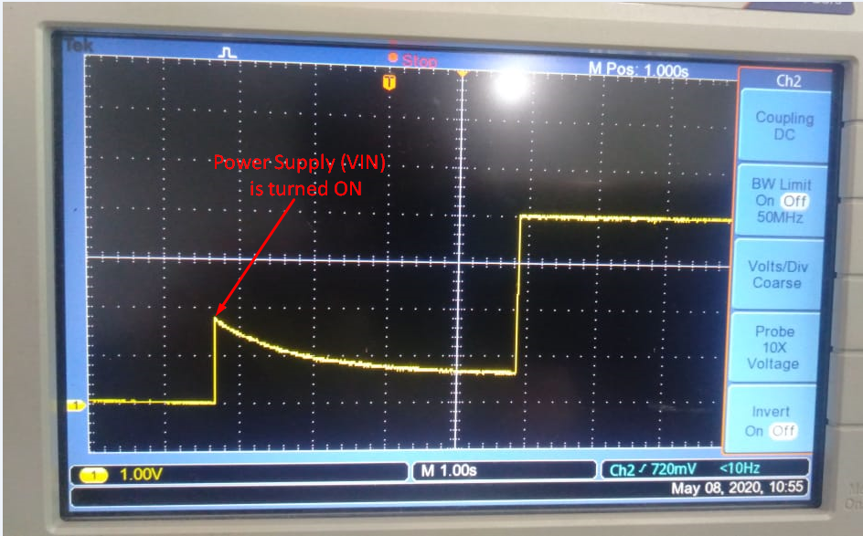

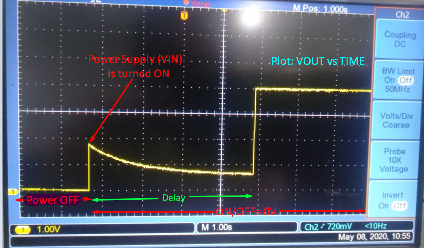

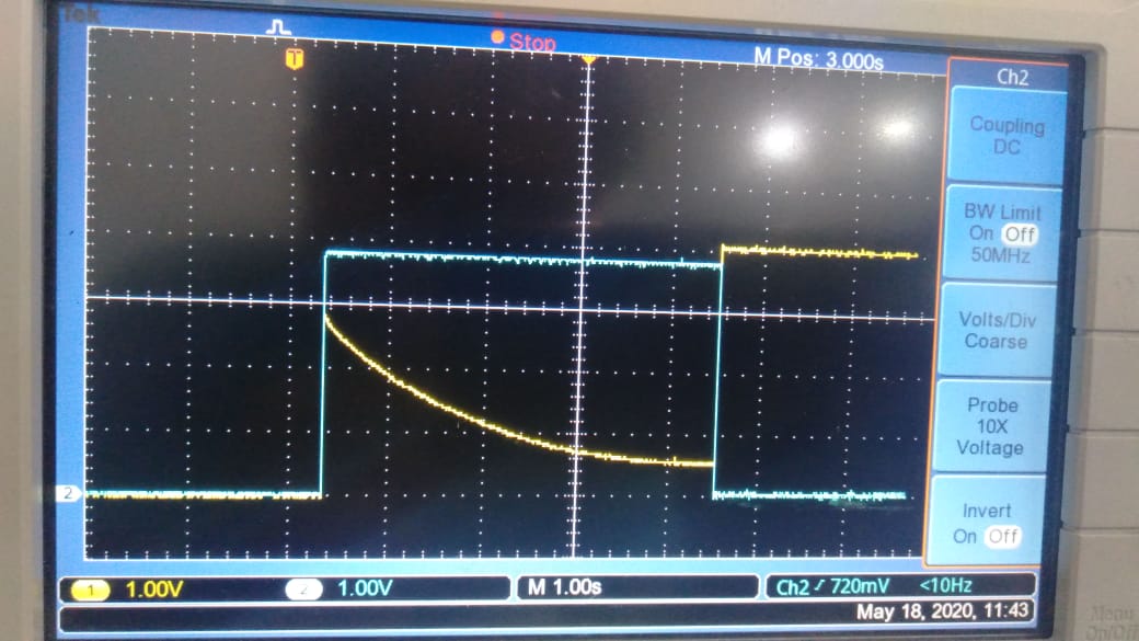

I have a system in which by default I have made the LM2596 regulator OFF. The ON/OFF pin is connected to controller (D26). I have programmed it in such a way that, the regulator (4V) will ON after 2 seconds of turning ON the power supply (VIN=12V). Also, the controller power is independent of LM2596's output power.
But, When I turn ON the power supply (12V), I have found a overshoot up-to 2V and then a decay for 4 seconds after which the regulator turns ON. The output voltage is fine (4V).
What could be the reason of this overshoot ? Also, I have given a delay of 2 seconds (mentioned earlier), but practically it turns ON after 4 seconds, Why? Please help.

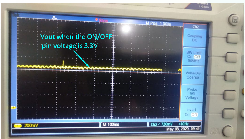

  • Hi Sam,
    The two plots are attached below:
    Thus, When ON/OFF pin voltage is 3.3V, Vout= 0.6V and when the ON/OFF pin voltage is 0V, Vout= 4V.
    Its OK, Right? My concern is that But, When I turn ON the power supply (12V), I have found a overshoot up-to 2V and then a decay for 4 seconds (although I have programmed a delay of 2 seconds) after which the regulator turns ON. So,What could be the reason of this overshoot ? Also, I have given a delay of 2 seconds (mentioned earlier), but practically it turns ON after 4 seconds, Why?
    NOTE: 10K in a pull up resistor. By default, the regulator should be OFF. When I trun ON/OFF pin low by controller (D26 pin), the regulator should turn ON. So, 10K is pull up is necessary for this operation, Right?

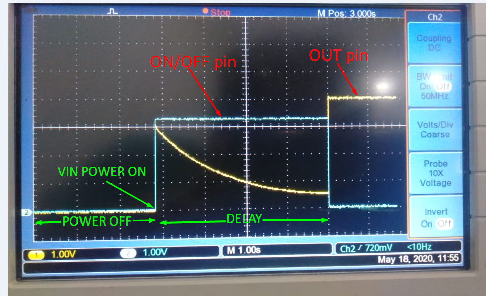

  • Dear Sam,
    Please find the oscilloscope graph below:
    So, my concern is that But, When I turn ON the VIN power supply (12V), I have found a overshoot up-to 3V and then a decay for 4 seconds (although I have programmed a delay of 2 seconds) after which the regulator turns ON. So,What could be the reason of this overshoot ? Also, I have given a delay of 2 seconds (mentioned earlier), but practically it turns ON after 4 seconds, Why?

  • Aakash,
    Did you test this after shorting the 10k resistor?
    It looks like the device is turning on and switching before the ON/OFF pin signals to the device not to switch. You can confirm this by zooming into the overshoot and seeing if the ON/OFF voltage is below the OFF threshold at startup. If so, you can resolve this with a pull-up resistor from VIN to ON/OFF or even a small capacitor from VIN to ON/OFF.
    -Sam

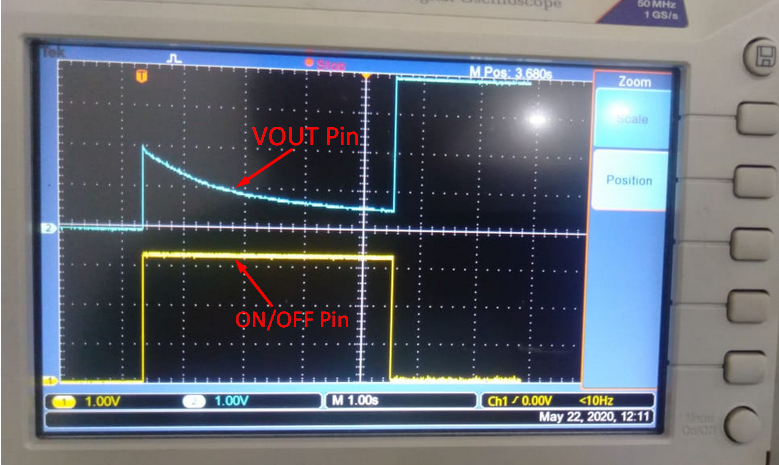

  • Dear Sam,
    Yes, the result is same with 10K and with shorting the 10K.
    At the time of overshoot, ON/OFF pin voltage is 3.3V and the overshoot voltage is 3V. But How can I know the OFF threshold voltage at this time? Please explain.
    Also, you are telling to use a pull up resistor/ capacitor from VIN (12V) to ON/OFF pin. But, I am controlling the ON/OFF pin by controller (ESP-32) pin whose voltage level is 3.3V. Will it be safe to pull up with 12V?
    Rather, I have tested with pulling up this ON/OFF pin to 5V. The graph is given below:
    The result is same. Right?
    Thanks.
  • Aakash,
    Yes the result looks the same. It may be that the 3.3V logic is not up when the 12V is applied. Please share a scope capture zoomed in to the overshoot so we can see the sequence of VIN and ON/OFF voltage. In addition, here are a few tests:
    First test:  Disconnect from the 3.3V logic and tie ON/OFF to 12V and power up 12V. This would damage your ESP-32 but we're just doing a test for proof of concept.
    Second test: Look at edge of 12V and ON/OFF at the instant of 12V turn on; look for the sequence.

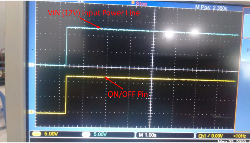

  • Dear Sam,
    I can share you the required graph by tomorrow.
    So before testing, please clarify the following:
    1) Should I do the test by removing 10K?
    2) You said, LooK at edge of 12V (VIN) and ON/OFF. Are you telling to compare the timing of 12V (VIN) and ON/OFF pin voltage?
    3) Try to slow down 12V (VIN) edge, but how? please give me some idea.
    4) "Try with an EVM connected to the system"- Which EVM?
    Thanks.

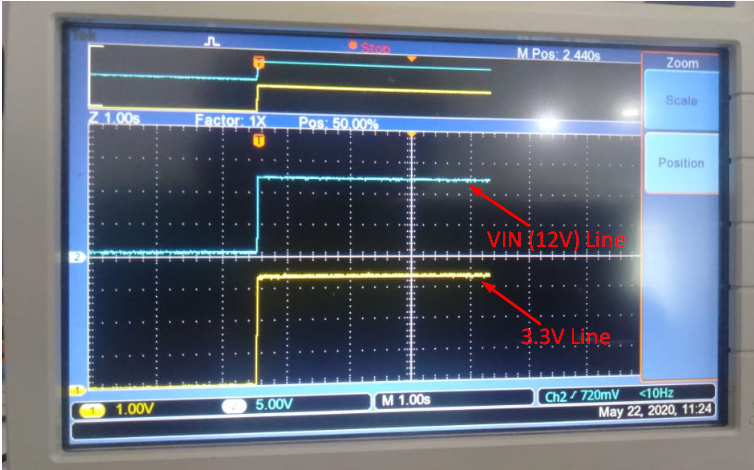

  • Dear Sam,
    Please find the following graphs:
    1) The below image shows the clear Overshoot when ON/OFF is pulled up to 3.3V line.
    2) The below images shows the edge of 12V and 3.3V Power line (ON/OFF pin is connected to the 3.3V line). Clearly no rise time delay/edge.
    3) The below images shows the edge of 12V and  ON/OFF pin when it is connected to 12V line. Clearly no rise time delay/edge.
    Also, unfortunately I don't have EVM.
    Thanks.
  • Aakash,
    It's hard for me to conclude that there's "clearly no delay" at a scale of 1sec/div. Next time you're in the lab, please check again at a finer time scale so that we can see which one is really coming up first. It doesn't take long for the output to rise (<1 pixel on the scope at 1sec/div). It would be good to zoom in so the rise from 10% to 90% is over 1 or two divisions.
