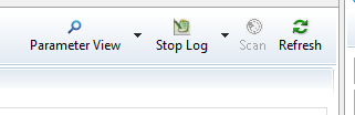

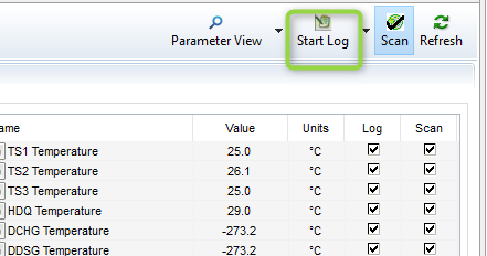

I would like to use the logging function from the BqStudio, as I know from other Bq's.
I pushed the Start Log Button and I chosed a file-name.
The file was generated,but it contains nothing. The memory stays at 0KB.
What am I doing wrong?

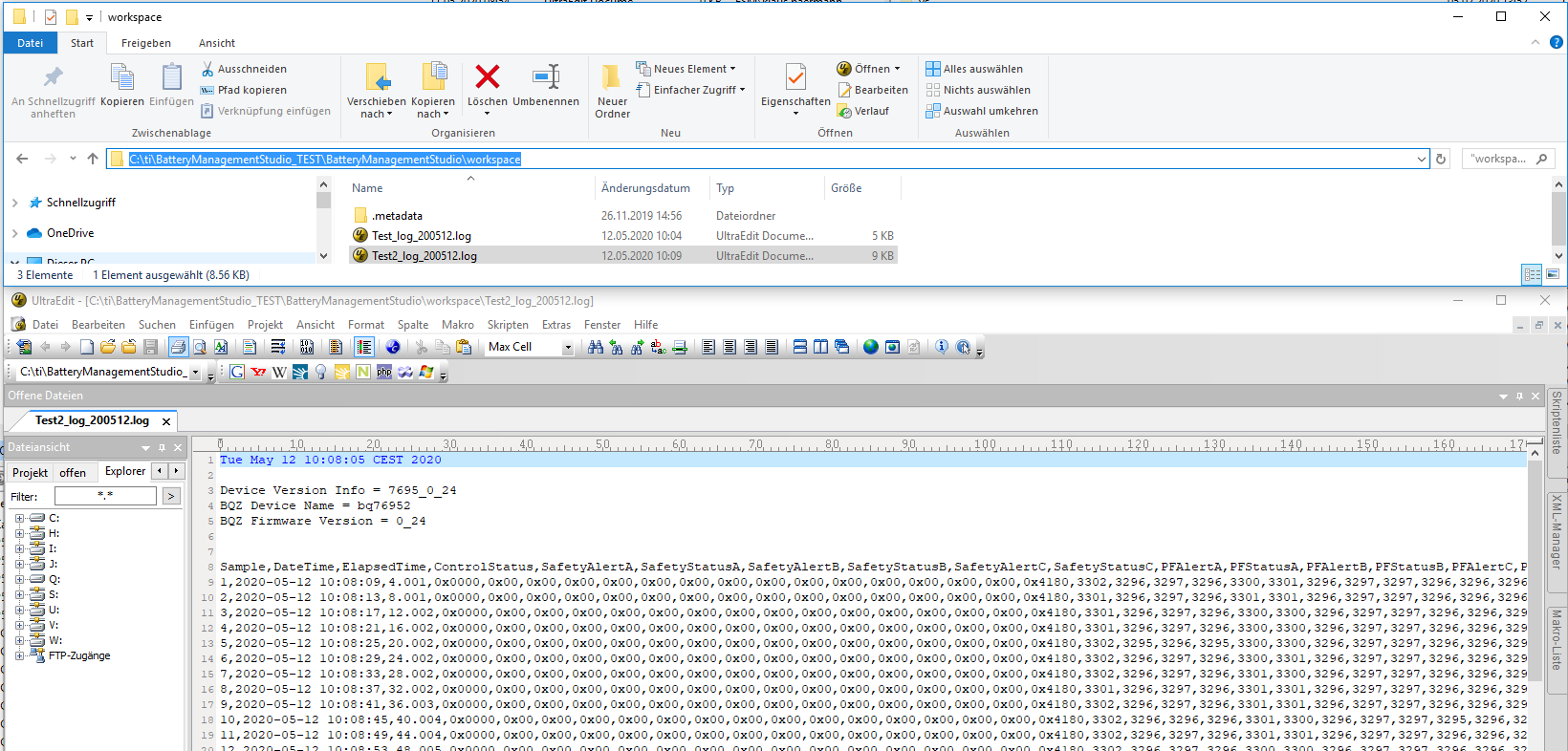

  • Hi Klaus,
    It seems you are able familiar with the tool, the BQ76952 should work similarly.  I can log with this version without a device or interface.  Suggestions:
    1. Try to locate the log file in the installation directory.  I have not experienced this but at least 1 user indicated this was helpful.
    2. Exit BQStudio, check that no other instances are running, then restart BQStudio
    3. Perhaps something went wrong with installation.  You might try to re-install the version to be sure all files were written properly.
  • Hi WM5295,
    thanks for your answer.
    Yes, at the moment I am using the bqStudio every day.
    I have changed the logging path to the workspace directory of the bqStudio and now it seemed to work:
    I could have thought of that myself. With the bq-Evaluation-Software and the bq20z65 and the bq20z95 it was the same behavior, I think.
    Thanks.
