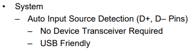

    I have another question on D+ and D-. is it a must for the charger to have D+ and D- line? what if it doesn't have D+ and D-?
    Based on below datasheet, I know that D+ and D- lines help in autodetection and no transceiver required for charging. If there is no D+ and D- in the charger, does it mean USB transceiver is a must for charging and not all the USB cable can charge the device?
    https://www.ti.com/lit/ds/symlink/bq24050.pdf?&ts=1589442520965

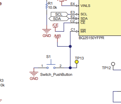

  • Hi Pragash,
    1) We are a battery-powered device. If MCU program battery charger to enter ship mode, the whole circuit will be turned off, including MCU. Can the program be successfully executed before the MCU goes to shut down! Toggling the low power mode would be practical, ship mode would not be. In low power mode the LDO and BATFET are still enabled.
    2) we program the product in the factory into ship mode. When the customer gets it, they have to bring it out of ship mode! Any example of the circuit to accomplish this? Example can be seen in BQ25155 evm here, using a pushbutton to pull MR pin to ground:
