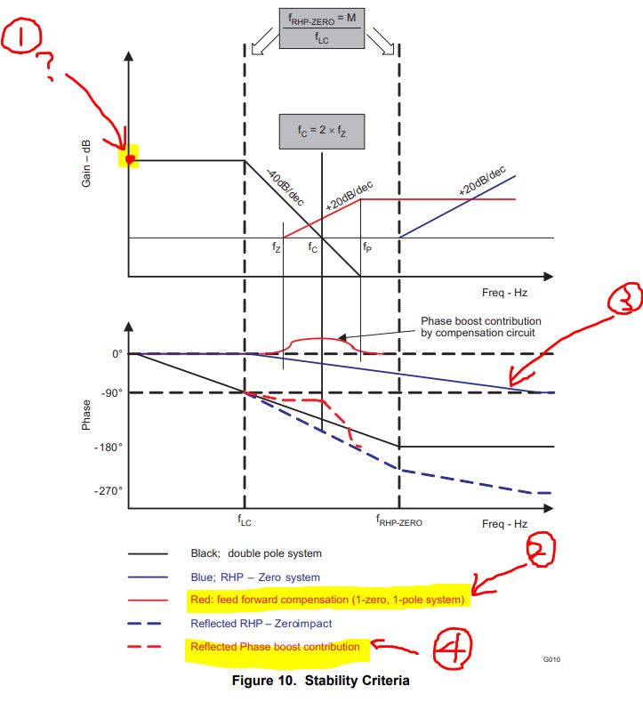

    Now I would like to find calculated or estimated value of compensation circuit.
    Could you tell me some values and answers related to figure.10 in TPS55332-Q1 datasheet?
    1. What is the initial gain of error amplifier? Also, Is the phase (f=0Hz) 0 degree?
    2. Which kind of compensation circuit type does feed forward compensation circuit (1 zero and 1 pole)?
      I guessed it is type2 compensation circuit, is it correct?
    3. Why does the blue line in phase characteristics affect as phase decreasing like pole? Isn't blue line in phase characteristics RHP zero?
    4. As same as question ②.
    Ochi
  • Hi Ochi-san,
    The plot is to show how different compensation networks will affect the stability of the system. You should read as the plot starting initially with the double-pole system, and then look at how a RHP-zero or feed-forward compensation will affect the double-pole system (the dotted blue and red lines). The solid red and blue lines show what the frequency response of the RHP-zero and feed-forward system look like in isolation.
    1) Error amplifier is implemented as an op-amp. You can assume as a very high value, which will be rolled off with a low frequency pole.
    2) Type-II compensation gives you a zero and a pole.
    3) RHP zero should give an increase in gain like a zero would provide (+20 dB), and a decrease in phase like a pole would provide (-90 degree phase shift).
    4) If you add the phase-contribution from the compensation network to the "Reflected RHP-Zero impact" phase, you will get the red line.
    In compensating this part, the compensation strategy in application design is that of Type-I compensation, which will roll off the gain so that your cross-over frequency is lower than the RHPZ, as you can see in section 8.2.2.8.
