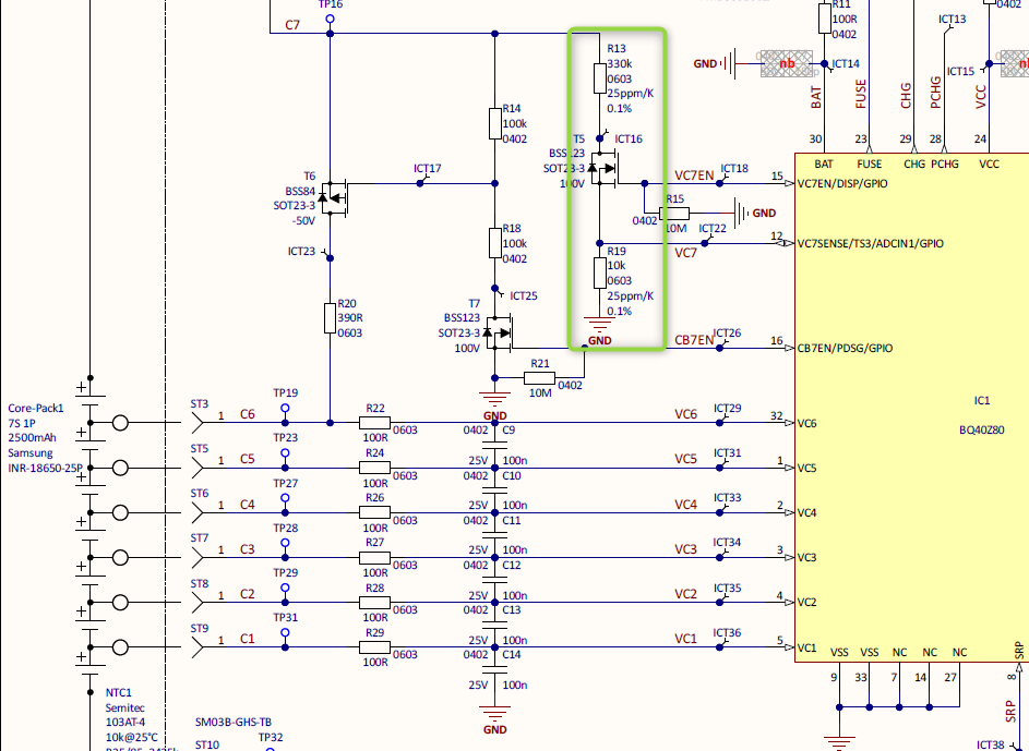

we are using the bq40z80 in a 7S1P  (Samsung SDI INR18650-25R) Applicaiton.

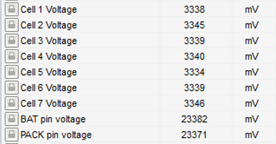

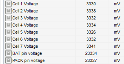

I have assembled the PCM of a relaxed battery and measured following Voltages:

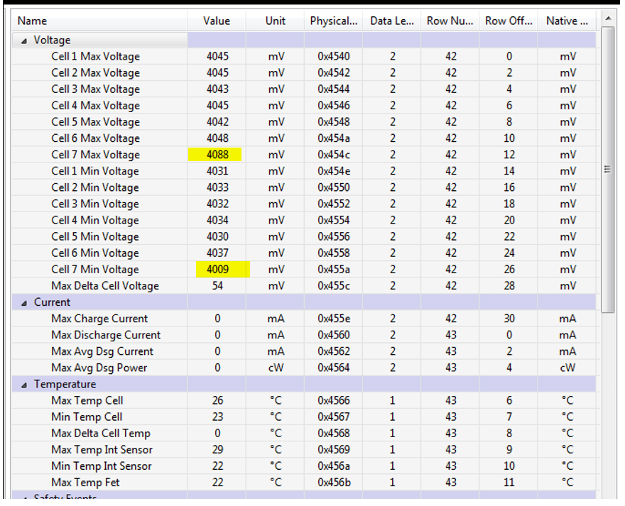

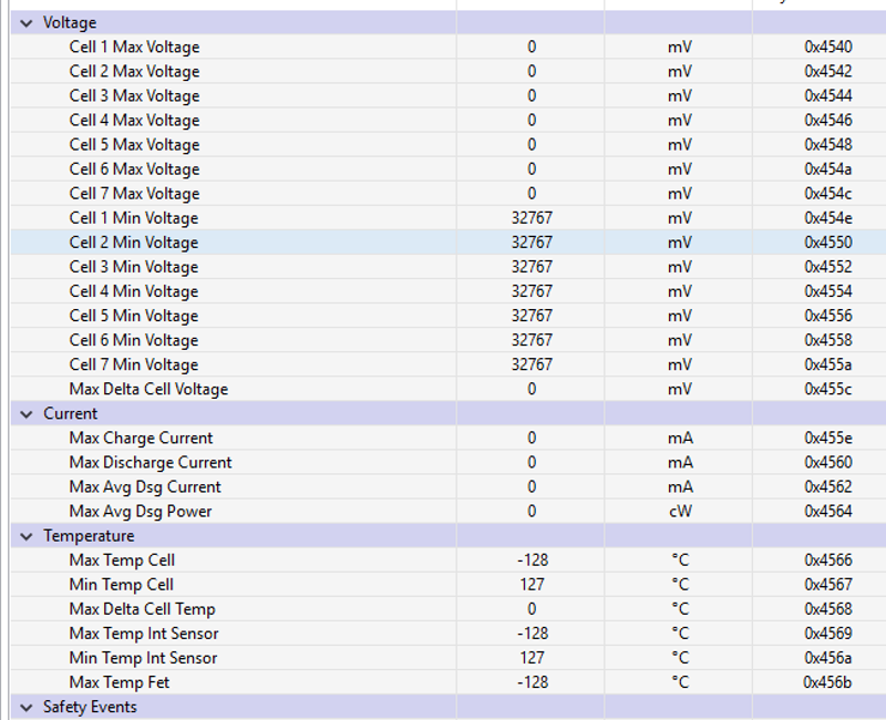

I have startet the "LF_EN" and let the pack stay for 24 hours.
At the beginning the Lifetimes look like this:

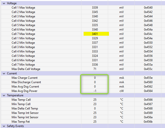

After 24 hours it looks like this:
The measured Voltages look like this:
Do you know why the max. Lifetime-value of Cell 7 is higher than the others?
The battery has seen no charge or discharge current and was absolutely relaxed.

  • Hi Klaus,
    The implementation of Cell Max/Min voltage is very simple.  It is the maximum or minimum voltage measurement the gauge has taken.  This Cell 7 voltage 3401mV was measured by bq40z80 in your 24-hour testing and then recorded.

    So I think the measuremt of Cell 7 is not so good, because the bq40z80 measures here over a external voltage divider and
    not direct like Cell 1, 2, 3 ..., isn't it?

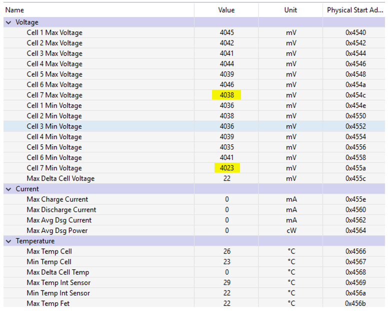

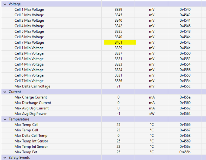

    At the beginning of the logging the Lifetimes looks like this:
    After 28hours it looks like this:

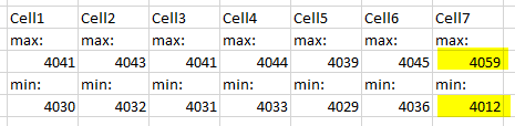

    The data logging has following min / max values captured:

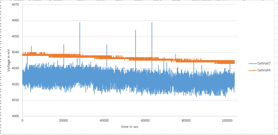

    Here is the curve over time for Cell7 and as comparision Cell4:
    As you can see there are spikes in the measuremet of cell 7.
    The values max values in curve/logging are smaller than the max values from the lifetimes.

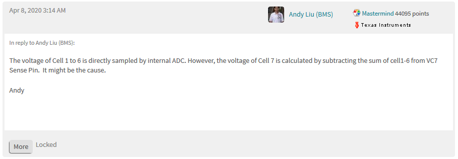

  • Hi Klaus,
    The voltage of Cell 1 to 6 is directly sampled. However, the voltage of Cell 7 is calculated by subtracting the sum of cell1-6 from VC7 Sense Pin. See the equation below.
    Vcell7 = VC7 - sum(Vcell1+.. + Vcell6)
    VC7 is using an external divider from the top of the stack, which is enabled by an NFET switch controlled using the VC7EN signal from Pin 15.  The noise on the VC7 might be higher.
    In your log file,  the abnormal Cell 7 voltage was reported when a higher noise was sensed via VC7.  Another evidence is the vBAT reading. Basically, vBAT is a filtered version fo VC7.
    Andy
