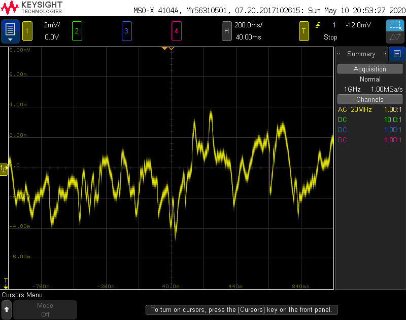

I have a board using a TPS7A33 and a TPS7A4701 to power some opamps. The input voltage is +/-34V and the output voltage is +/-32V. Somehow the TPS7A33 keeps getting damaged. The symptoms are the voltage at the FB pin changes (sometimes out of spec to -1.215V) which causes the output voltage to change. The output also begins drifting around by up to 10 mV (see scope image below).
I thought this: https://e2e.ti.com/support/power-management/f/196/p/762824/2819981 was the problem so I put a schottky diode in parallel with R52, with cathode at ground. The forum post I linked says anode to ground but I don't think this can be right because it would short out R2 due to the fact that the reference voltage is negative. After adding this diode to a working board however, I still managed to kill the TPS7A33 after a few power cycles.
Here is a screenshot of what the output looks like (AC coupled) after the damage event:

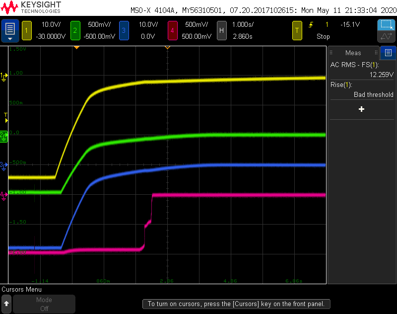

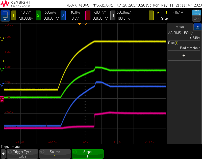

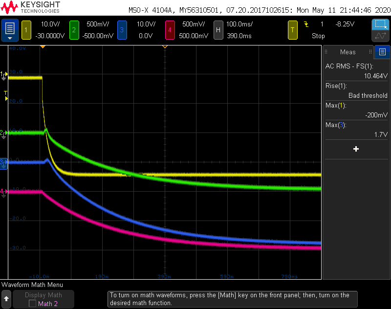

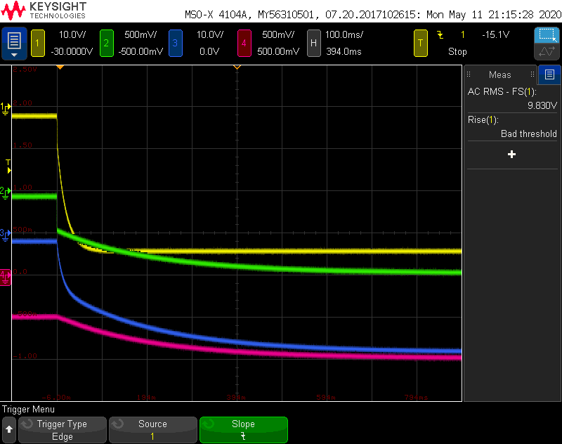

    I have another set of power supplies on this board which I have been turning on/off manually, so just to be safe I did a measurement of TPS7A33 power up and power down with the the other supplies off and with them on. All measurements are below.
    The only abs max violation I can see is that on one of the power up plots, Vout jumps to around 1.5V above ground, which is higher than the 0.3V abs max in the datasheet. I don't know why this is or how to prevent it, but you can see the same jump in the Vfb plot (although the Vfb is not violating abs max).
    In all plots, chan 1 (yellow) is Vin, chan 2 (green) is Vfb, chan 3 (blue) is Vout, chan 4 (pink) is Vnr/ss.
    Other supplies on:
    Other supplies off:
  • Hi Justin,
    I posted a reply earlier, but for some reason, it did not go through. I have reviewed your plots and for the one with "other supplies on", the output that was jumping above 1.5V was an indication that the ESD structure on the output pin is damaged. I have also noticed the NR pin voltage only goes to around 0.5V which also means the internal NR circuit may also have been damaged. In the plots, the Vin is still at negative during the Vout jumping to 1.5V, what do you have on the load side? Is there anything pulling output pin higher?
    The other plots with "other supplies off" have the NR voltage goes above 1V, and I am trying to understand what's the difference between the other supplies "on" and "off" in your application, will you help to clarify?
