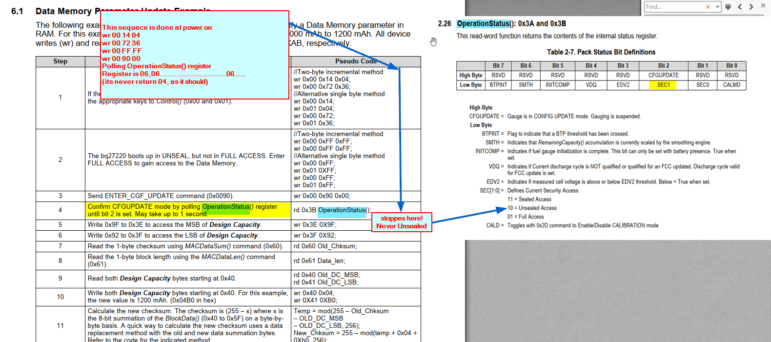

We are doing a product design for beyerdynamic in which we use the BQ27220 chip. We now have some random case (<1%) where the chip for a given period is not responding as expected when we are trying to get Unseal access according to slubbd4 section 6.1. to read or write some parameters like design full capacity
After Unseal request code is executed, we are doing the expected polling to make sure the device is put into stable access mode. But we sometimes never get a SEC[1:0] equal to 10 (unsealed access)
As it in most case works fine it is hard fro us to understand  what is causing this.
We already have ”some” delay’s before and after the step 4 (TI question asked in support case: CS0193398. https://ticsc.service-now.com/csm?id=csm_ticket&table=sn_customerservice_case&sys_id=eca95aa6dba0505456e4d7b2f3961973&view=csp
We have approx 10msec between step 1, 2, 3 and 4. If the return is not unsealed we poll 10 times with 200msec delay between them.
Included picture on what is executed. we also have an IC2 trace of a case where it goes as expected and one were it do not. We cannot see any direct difference between the cases.

  • Please make sure you do not violate the specific timing requirements for this gauge. Please pay close attention to 7.3.1.3 (http://www.ti.com/lit/ds/symlink/bq27220.pdf). If you violate this, the gauge will not just stop working but some write operations may fail randomly.
    I recommend changing all I2C writes to single byte writes, not auto-increment multi-byte writes (see the //Alternative single byte method comment in the data memory update example) and add the appropriate delay.
    I believe our code meet the timing demand, but we do not use single byte write as we did not see that as a mandatory demand in the TI documentation.  We will try to see if that gives any difference.

  • The gauge uses the following internal process for unsealing:
    Gauge is sealed (e.g. after a reset. This can be a power on reset because the voltage dropped below the POR threshold and then recovered):
    * gauge receives first unseal key (16-bit):
    * if the key is correct, the gauge starts a 4 second timer.
    * gauge receives second unseal key (16-bit) within 4 seconds:
    * if the key is correct, the gauge unseals and stops the timer.
    * if the key is incorrect, the gauge restarts the 4 second timer.
    --> the gauge will not accept another unseal key until this 4 second timer expired
    * if the second unseal key wasn't received within 4 seconds:
    * the internal state machine for the unseal sequence resets and the host must start the unseal sequence with the first unseal key.
    --> If you run into problems unsealing the gauge, stop for 4 seconds and make sure that there is no communication with the gauge until 4 seconds elapsed. Then make 100% sure that you write the first unseal key followed by the second unseal key while not violating any timing restrictions that are specified in the datasheet.
