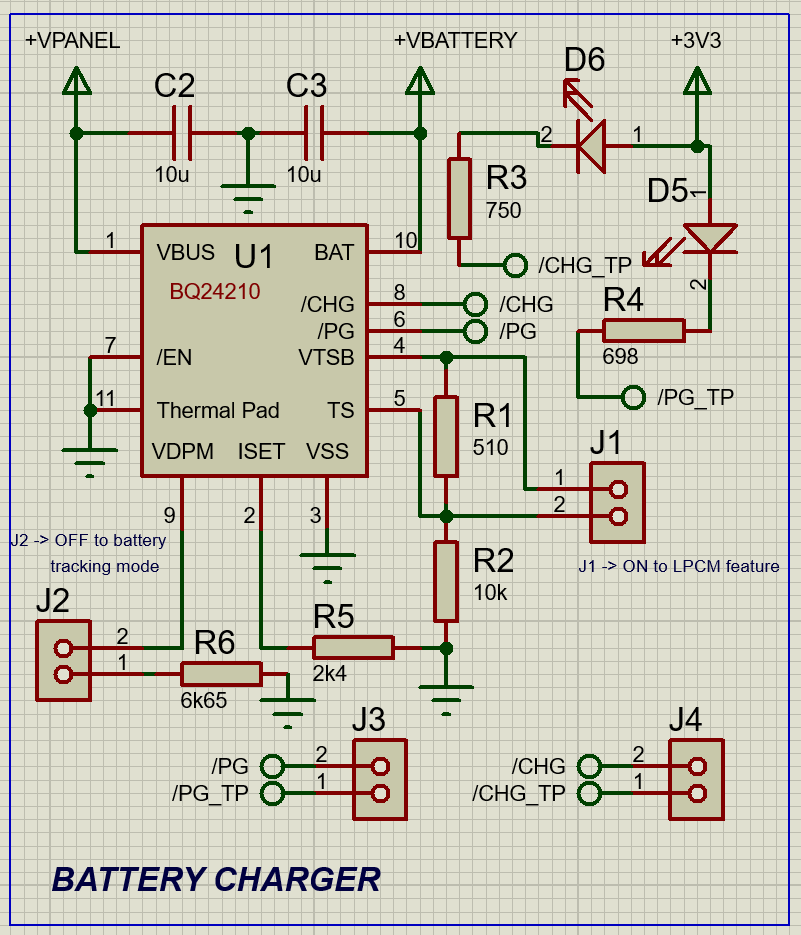

As the battery will always be connected to the system, it is necessary to deactivate the security timer, for this I use the LPCM feature and also, when using a solar panel I use the battery tracking mode.
In addition, I attach part of the schematic. As you can see, there are certain jumpers and additional elements but they are there to be able to use different modes of operation of the bq24210 (as if it were a custom EVM).
Based on the schematic, the J1, J3 and J4 jumpers are on. J2 is off.
J3 and J4 are jumpers to activate the lighting of LEDs to display the 'POWER_GOOD' indication (D5) and 'CHARGING' status (D6).
J2 is off for battery tracking mode
J1 is on to use the LPCM feature and therefore disable the safety timer.
Now, the problem is that after a time between 20-30 h (I could not limit the time interval anymore) the IC bq2410 stops charging while the battery is always below 3.8 V, so with that voltage shouldn't stop charging. In addition, it is a sunny day and the POWER_GOOD LED indicates the sufficient voltage level to continue charging the battery.
To start charging again I have to disconnect the battery for a time (usually less than a minute). Why does this happen?

    I am going to try to replicate your issue, it seems like the d/s may need to be revised slightly if the VIN DPM timer can terminate charge when battery under 4.1V. Your schematic looks correct.

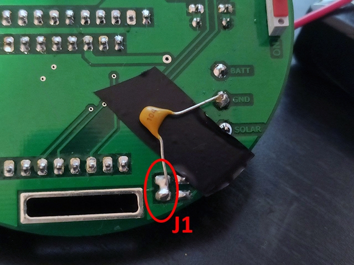

    For now you can try adding a 0.1 uF cap from TS pin to ground. This may help.
  • Hello Nick and thanks.
    I've already soldered a capacitor of that value on a couple of PCBs. Looking in your support forum I read that it could help but it did not work in my design.
    I attached a picture. The 0.1 uF capacitor is soldered (on the bottom layer) between GND and the jumper J1 that is has its two pins also soldered, that is, it is set to ON.
    Thank you.
    Fran Martín.
