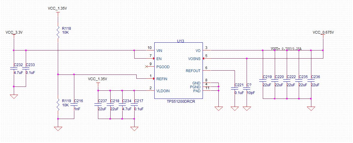

Please review that this TPS51200 can VOUT= 0.675V.
If I connect the VREFIN (with 10K PU/PD)= 1.35V and VLDOIN= 1.35V in the attached:
In many of the answers in E2E I see that you can keep PGOOD floating, how is this PGOOD pin of TPS51200 is different from the rest?
attached rest answers:
https://e2e.ti.com/support/power-management/f/196/t/23287?BQ24073-PGOOD-pin-can-it-be-left-floating
https://e2e.ti.com/support/power-management/f/196/p/883345/3267540#3267540
Theoretically the open drain pin could be damaged by noise if the pin is floating, though the risk is low.
Different engineers have different judgement on the risk.
If you do want to float the pin, it is fine. Take your own risk.
Btw, another solution is to ground the pin.
