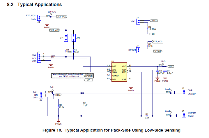

We want to check with you which circuit is correct according to your BQ27220YZFT datasheet. especially for the SRP and SRN' s connection

Let me provide more details. BQ27220 can be used as a pack-side gauge or system-side gauge.
The simplified schematic on Page 1 of the bq27220 datasheet is for the system-side configuration, while Figure 10 is for a pack-side application. They are both correct.
If you are looking for a system-side configuration, the schematic in the bq27220 EVM user's guide is what you need.
