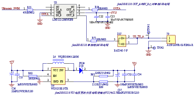

I will follow up this issue as Lin has asked before. Please see the below link for details:
https://e2e.ti.com/support/power-management/f/196/t/874169?tisearch=e2e-sitesearch&keymatch=LM5111
Now I asked customer to test the resistance from PINs to VEE. Please see the below data in the picture.
Is the damage is caused by the conclusion in the above link, I suppose the INA to VEE resistance should be normal and INB to VEE resistance may be drop to a small value. But now either INA and INB resistance is normal or both of them is lower than normal value.
So can you give me some other assumption that may cause this kind of damaged?
Thank you!
