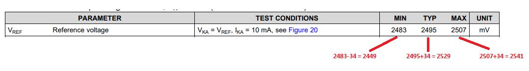

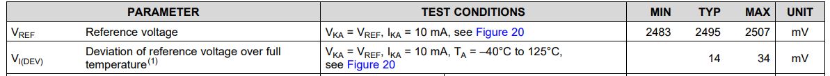

I am using TL431B-Q1 below is the reference voltage mentioned in datasheet.  and the reference voltage drift throughout temperature is also mentioned.
I am considering the temperature range from -40degC to 125degC so the values for V.REF I am considering is as below.
Considered worst values as per above image.
Need to confirm whether my considerations are right.
