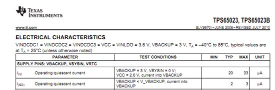

We need to know the consumption of PMU TPS65023 on VBACKUP pin when product is off.
Our customer uses an external RTC and would like to correctly size the Back-up Battery.
This consumption on VBACKUP is : Iconso PMU (internal) + Iconso on VRTC pin.
Consumption on RTC pin in know. We need to have a estimation of internal PMU consumption on VBACKUP pin.
Seems to not mentioned in the datasheet.
