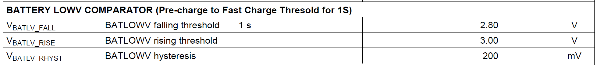

    1. BQ25703A measures the battery voltage through SRN pin and uses a hysteresis comparator to decide Precharge or Fastcharge. For example, when the 1S battery voltage is lower than 2.8V, it is in Precharge; when the 1S battery voltage is higher than 3.0V, it is in Fastcharge. There is a 200mV hysteresis in the battery lowv comparator. See below spec excerpted from the datasheet.

    〉1. BQ25703A measures the battery voltage through SRN pin and uses a hysteresis comparator to decide Precharge or Fastcharge. For example, when the 1S battery voltage is lower than 2.8V, it is in Precharge;
    〉when the 1S battery voltage is higher than 3.0V, it is in Fastcharge. There is a 200mV hysteresis in the battery lowv comparator. See below spec excerpted from the datasheet.
    Could you tell me ”VBATLV_FALL, VBATLV_RISE, VBATLV_RHYST" for 4cell?

  • You can scale up for 4S by multiplying x4.

    1.For 4cell, is the following understanding correct?
    ・BATLOWV falling threshold: 11.2 V
    ・BATLOWV risign threshold:12 V
    ・BATLOWV hysteresis:200mV
    2.Could you tell me the maximum and minimum values of ”BATLOWV falling threshold" "BATLOWV risign threshold" "BATLOWV hysteresis"?

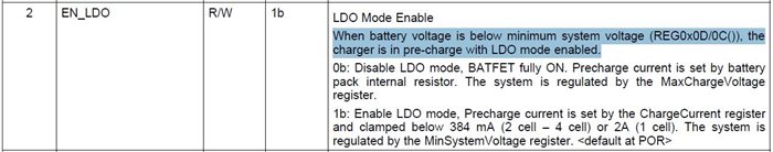

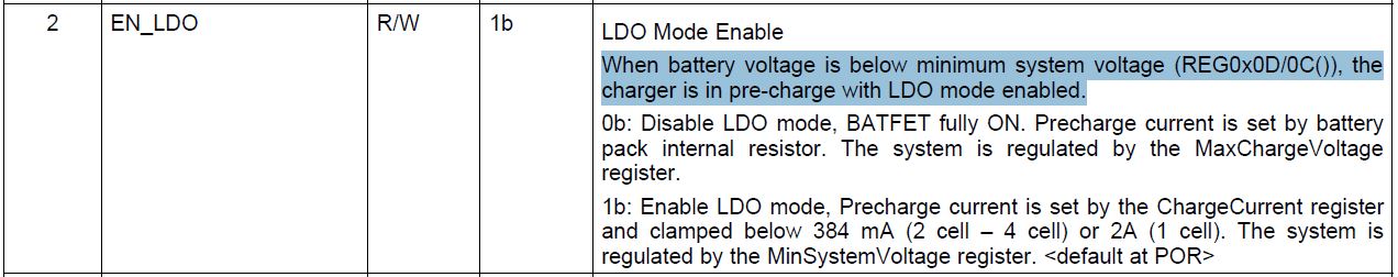

    3.In LDO Mode Enable, does MinSystemVoltage setting affect the comparator threshold?
      Following contents are described in the data sheet.
           For example, if the MinSystemVoltage setting is 15V, Which setting has priority?

  • 1. BATLOWV falling threshold: 11.2 V
    ・BATLOWV rising threshold:12 V
    ・BATLOWV hysteresis:800mV
    2. There is no distribution data.
    3. Min system voltage won't affect the comparator threshold. The BATLOWV comparator is fixed in the part. When EN_LDO is ON, the charge current will be clamped when battery voltage is below the Min system voltage. I don't think there is a conflict. Both will be effective as described. In this case, the EN_LDO extends the pre-charge current to Min system voltage.
    Hope this clarifies your question.
