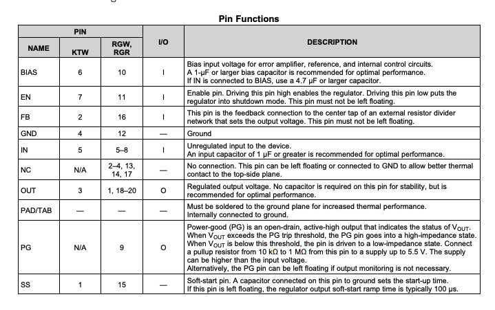

We accidentally manufactured boards which have a solder bridge from pin 14 NC to pin 15 soft start.  Since we do not know what PIN 14 is connected to internally we would like to know what is the consequence of this error and if we should rework our boards.

    The TPS744 NC pins have no internal connection:
    While it is not normal to connect to the SS pin, there is no internal connection so there will be no impact.
