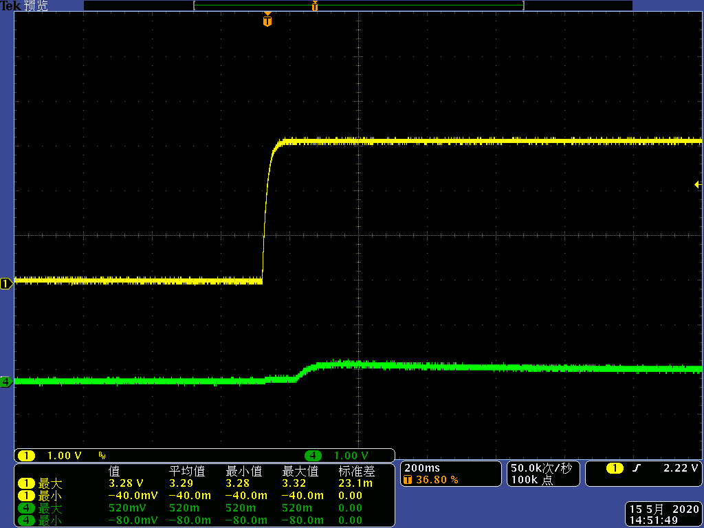

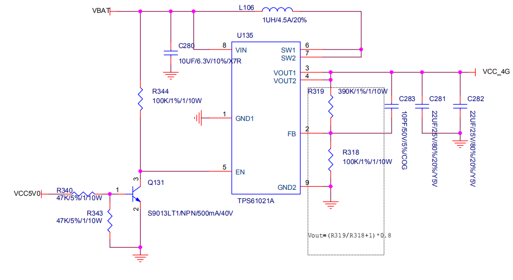

We use a TPS61201A be a power supply for 4G wireless module which supply voltage be set at 3.75V.
And we do the testing of TPS61201A circuit performance about start up with load.
When the loading current over 150mA,the IC can not start up successfully.
The circuit shown below :
Test data :
   start up failure at 0.155A loading as below shown
Please help me to analyze this problem ,thanks !
