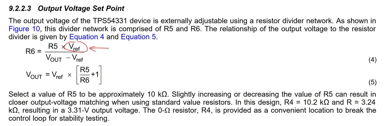

can anybody tell me what is meant with V_ref in this formular? Page 15 in datasheet and topic point 9.2.2.3

    Hi Fabian,
    Vref means voltage reference, and you can find its min/typ/max value at the Electrical Characteristics table(Page6).
