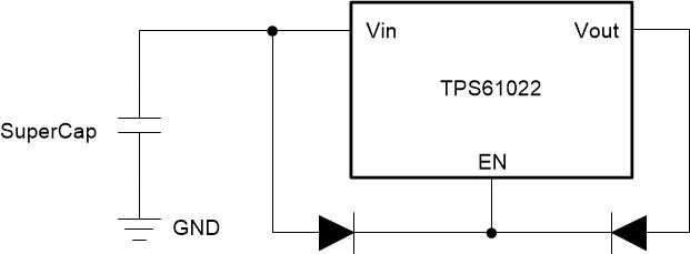

    Below picture is an example of EN pin connected to Vin and Vout. When the supercap is charged higher than 1.8V (ULVO threshold of TPS61022), TPS61022 starts switching and the left diode conducts. Vout rises to the regulated 3.6V so the right diode conducts. With this connection, even the supercap voltage decharges below 1.2V, the EN pin is still pulled up to Vout.
  • Hello Zack,
    thank you very much for the info. It works.

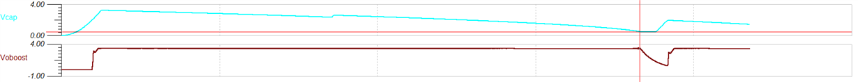

    However, I noticed that also without adding the diodes that the input voltage at start should be higher than the EN voltage. But during normal operation, if Vin gets lower, it can still get as low as about 0.5 volt before the boost is disabled.
    Below are the waveforms;
    Vcap is the supercap voltage and Voboost is the output of the boost (set at 3.3V however).
    May you please check that. Either the simulation model needs some modifications to cope with the actual performance or the actual performance has some hysteresis.

  • Hi Amr,
    That's the feature of TPS61022 and TPS61023.
    The rising UVLO is 1.8V and falling UVLO is 0.5V. That means TPS61022 needs to start up from 1.8V supercap voltage at least. It is able to regulate the output voltage until supercap discharges to 0.5V.
  • Hi Zack,
    If I rightly understood, the UVLO assumes that the EN is still set at the 1.2V (through an external supply or whatever). But in the circuit we discuss, the VIN and EN pins are tied together, therefore both Vin and EN reach the 0.5V at the same time. Therefore, I was thinking why the IC isn't shutdown when the EN pin gets less than its 1.2V?
    Amr
  • Hi Amr,
    The EN logic low spec in EC table is 0.35V minimum. The EN logic high spec in EC table is 1.2V maximum. These two value are the key spec in applications. It means if customer would like to enable the device completely, the EN voltage should be higher 1.2V. If customer would like to disable the device completely, the EN voltage should be lower than 0.35V. In another word, if the EN voltage is between these two spec, for example 0.8V, the device is either in active status and shutdown status.
    That's why in simulation, even the EN pin gets less than 1.2V, the device isn't shutdown.
  • Hi Zack,
    Thanks alot. May be the official name of that isn't hysteresis. But from the simulations it looks exactly like hysteresis. At Startup Vin is less than than the 0.35V and the system is off. Vin still increases getting between the 0.35(0.45V) and the 1.2V but still system off till Vin reaches the 1.2V then the system is enabled. Now if Vin (tied to EN) gets less and going below the 1.2V the system still on till Vin reaches the 0.35-0.45V then the system is off. Isn't this hysteresis? May be there is no need for the diode connection in the previous message?
    Amr
  • Hi Amr,
    The simulation helps customer design the circuit but it's a simplified, ideal model, not a real IC. Please always refer to the Electrical Characteristic Table in datasheet. That's what TI promises.
    The datasheet has detailed description and explanation about Vin rising and falling UVLO threshold and EN High & Low threshold. Please follow datasheet.
  • Thanks Zack
  • Hi Amr,
    I just double confirmed the EN pin High and Low threshold with our experts. In your case, you can connect EN pin to Vin. Although there is no word of hysteresis in datasheet, but the EN pin low threshold max spec is 0.45V. So there is no problem.
    Please ignore my previous post. Sorry for that.
