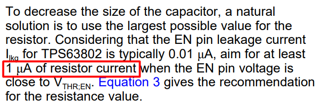

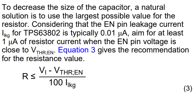

I do not need a preceise delay so I am ok with the loose EN pin. In my case, I am just needed a delay of around 1s. That requires a big capacitor and in order to reduce capacitor's size, I have to use the largest possible value of the resistor. What I do not know is how to calculate the resistor...

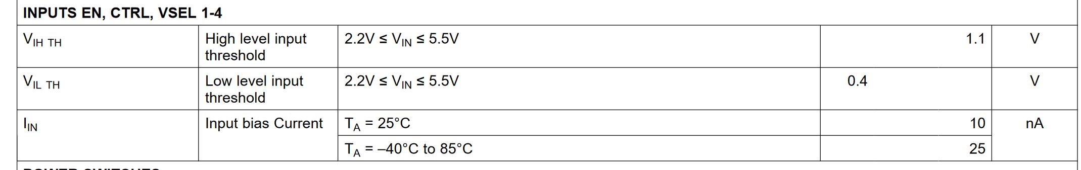

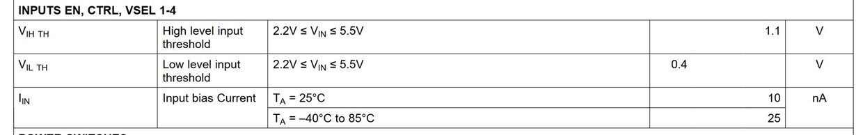

Basically, the guide explains how the resistor is calculated but I cannot understand it.. Also, I cannot find what is the EN leakage current of TPS62740..
The guide sais:
Any advice?
