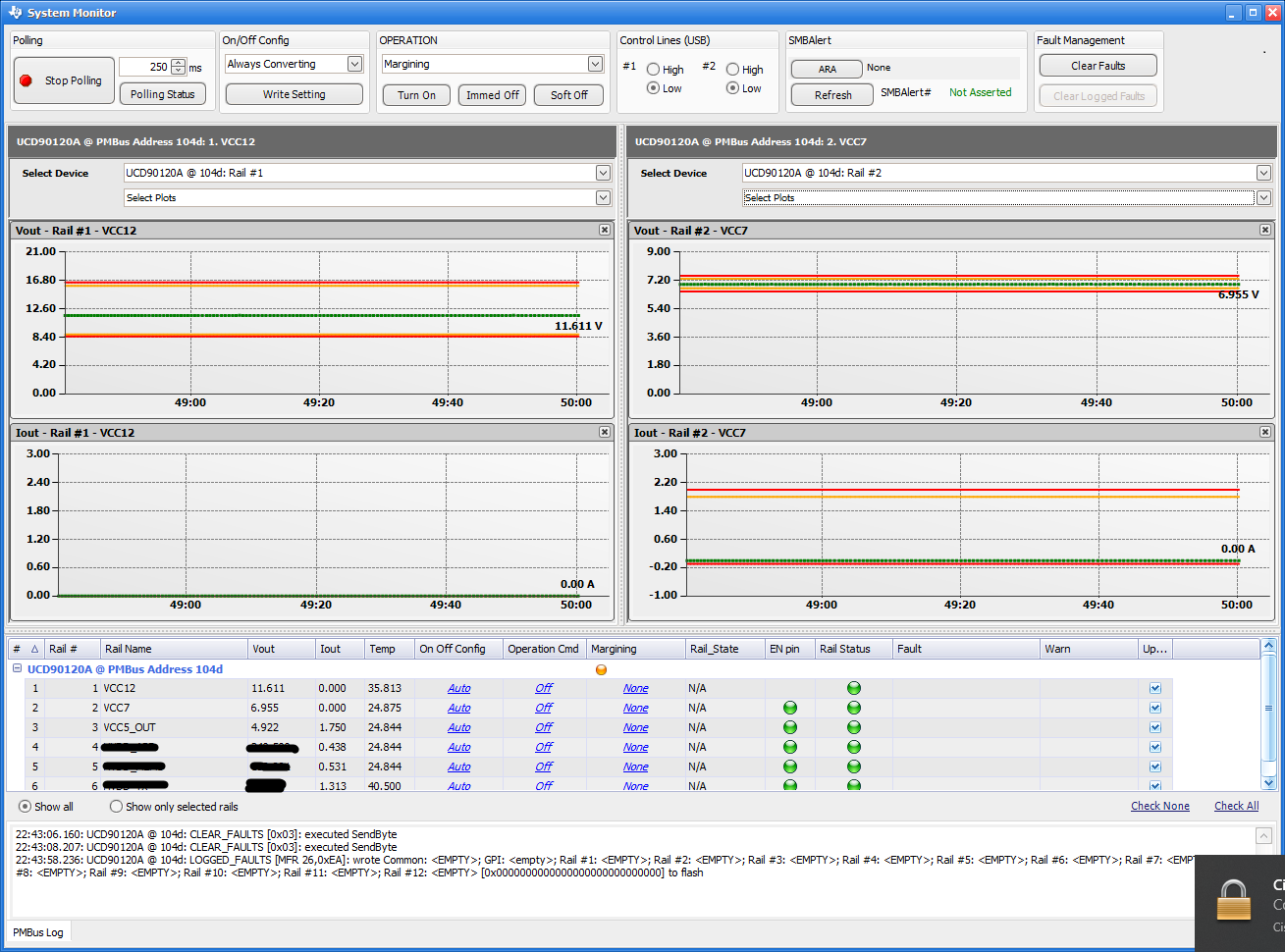

I need to add more than 2 rails to the Digital Fusion SYSTEM MONITOR screen. By default it lets you monitor 2 rails, and I don't see an option to add more rails to monitor.

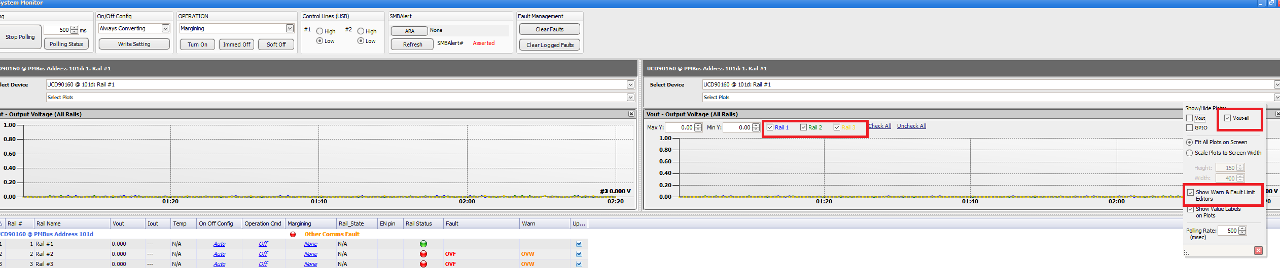

    Please follow the snapshot to enable the multiple rails.

  • Thanks for replying. What I am looking for is a separate plot columns for each rail. The way you are showing other rails are through "Vout All" which shows all rail voltages in the same plot, which is messy and confusing. I would like to have a separate column or separate plot for each rail where I can see Vout and Iout for each rail.

    By default, system monitor allow two plots for two different rail. but under each plot, you can select both VOUT and VOUT(ALL). under VOUT(ALL), select the target rail, so that you can have 4 plots for 4 different rails.
    That's what system monitor supports the most.
