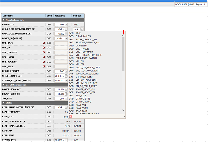

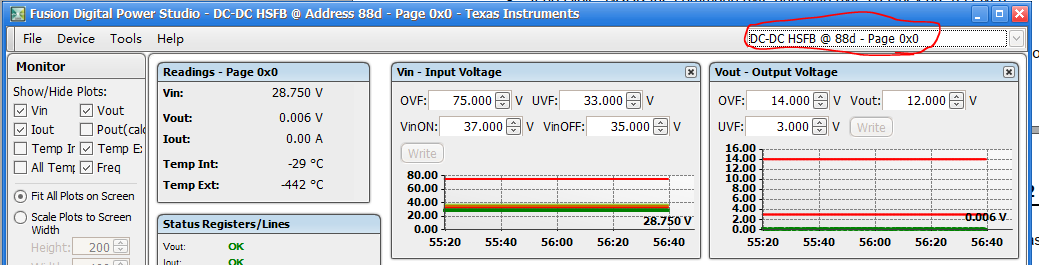

I'd like to use single UCD3138 to control 2 HSFB power supplies, and hope the fusion GUI can be used to monitor those 2 power supplies data.
I see the fusion gui will display page 0 at default, can you please help me know how to change it to disaplay data at other pages? Thanks...
  • Hello Jack,
    As you know, first you need to make some changes to the firmware, in order to accommodate paging support.
    Including the setting of CMD bit mask in order for the GUI to have a way to verify that page command is supported.
    If GUI at the first scanning of the power supply realizes that the power supply supports paging, then the combo box that you have highlighted by a red line drawn around it, will be active. Meaning that the arrow at the right side of the combo box will not be grayed out. And will let you to select the desired page.
    Hope this makes sense.

    I've tried it on HSFB code which is downloaded from ti website, and implement the page command and set the CMD bit mask for page command. But it's still can't work, can you please share some comments?
    Here are what I've done:
    1. enable the page command in pmbus_topology.h
    #define PMBUS_CMD_00_ENABLE (1)
    2. And related page command code, below code are just for testing purpose, I don't added another pmbus_dcdc_config[1] yet, since I use the same data for 2 pages in current test stage.
    Uint8 page_number = 1;
    Uint8 pmbus_read_page(void)
        pmbus_read_one_byte_handler(page_number);
        return PMBUS_SUCCESS;
    Uint8 pmbus_write_page(void)
        page_number = pmbus_buffer[1];
    Uint8 pmbus_read_write_page(Uint8 pmbus_read)
        if(pmbus_read)
            return pmbus_read_page();
        else
            return pmbus_write_page();
    3. From the fusion GUI, the page still can't be selected, and always point to page 0x00. And you can see that the PAGE comand bit mask has been set. Thanks...

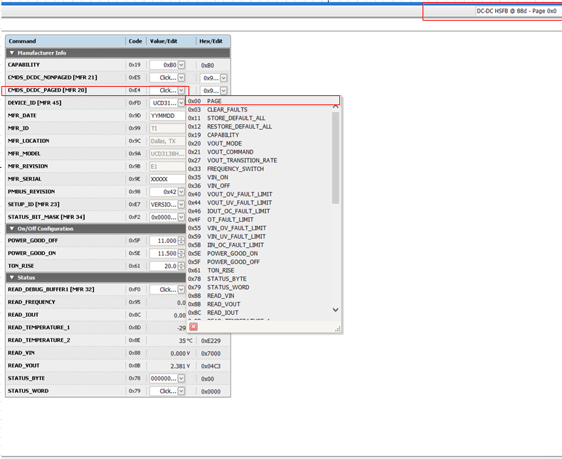

  • Another test that set the bit mask in CMDS_DCDC_PAGED for page command, page are still can't be selected.

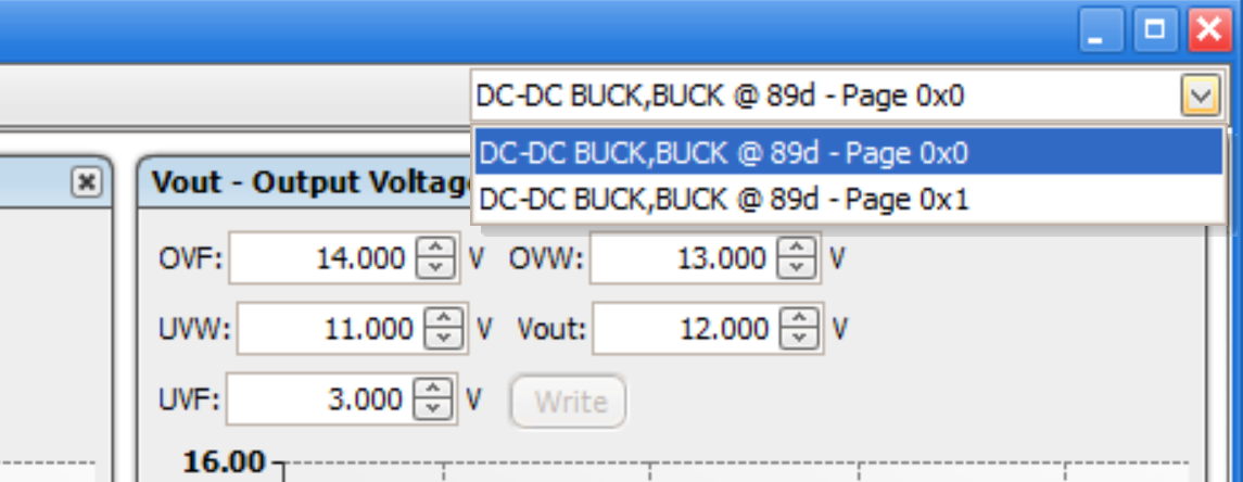

  • Hello Jack,
    The issue was due to the SETUP_ID as I guessed.
    I took the LLC code and replaced the original SETUP_ID with this:
    #define SETUP_ID "20|1V2VNN|BUCK|BUCK"
    and recompiled, that is all. And now the second page shows up in the GUI.
