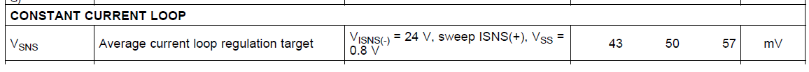

I plan to use the LM5176 device.
I would like to ask you about variations in electrical characteristics.
The average current regulation loop is 50 mV (TYP), and product variations and variations in the entire temperature range are about 16%.
I want to use this product with as little variation as possible.
Can you show me the temperature variation data and the statistical data?
  • Hi Kaji,
    Thank  you for your interests, but the datasheet only specifies the overall variation range, and I don't understand why the statistic data would help, because you need to design to consider the worst case.
    If you want to tighter tolerance, you may consider the INAxxx device for high precision current monitor, and use that device to control the LM5176 for Constant Current operation, like the concept in the following diagram.

  • Thank you for your reply.
    The reason why the statistical data is necessary is that the current detection variation is narrowed down from the rated current so that it does not affect CPK.
    100% of the current detection values are inspected and not used if it exceeds the target value.
    For the reasons above, I need the data, do you have the data you can provide to me?

  • Hi Kaji,
    I will check if the info is available for sharing.  If not, please use the datasheet limits as the guideline.
    Youhao
    Is it possible to tell me if a way to add an external current monitor is available for the LM5146?
  • Yes, you should be able to use the same scheme for the LM5146.
    By the way, I have checked with our team and the Avg current limit has very and very little dependency on temperature.  The majority of the variations are caused by process tolerances. So, you should use the datasheet limits as the design guideline.
