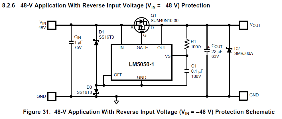

LM5050-1: What is the function of "D3" in Figure 31 of data sheet
Part Number: LM5050-1
Hello.
I wish to use the LM5050-1 in a Reverse Polarity Protection application. Figure 31 shows a diode D3 between IC ground and circuit ground.
It is not present in most of the other Figures in the data sheet.
My question is - Is D3 required for reverse polarity protection applications?
If yes, then can you explain why?
