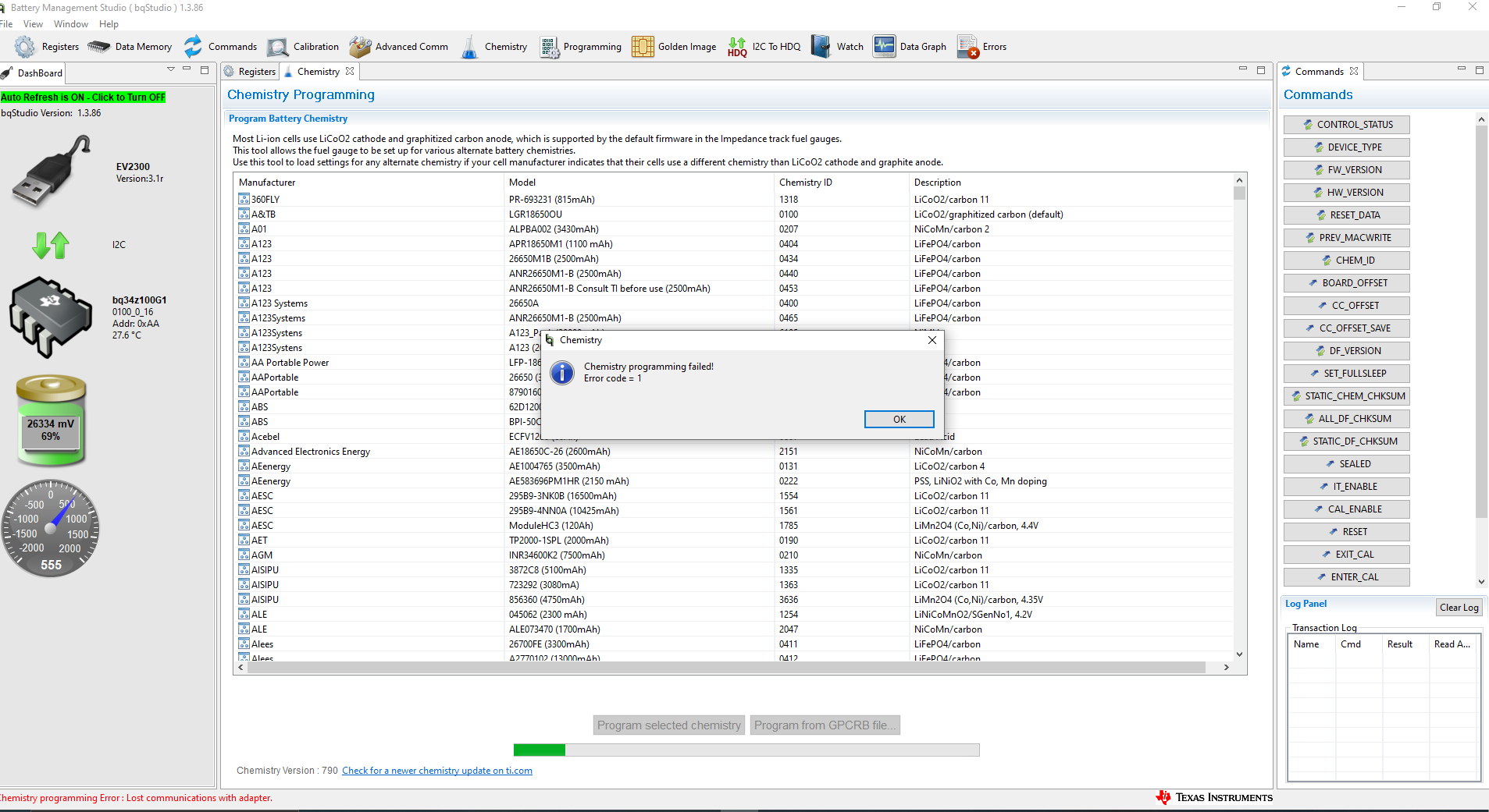

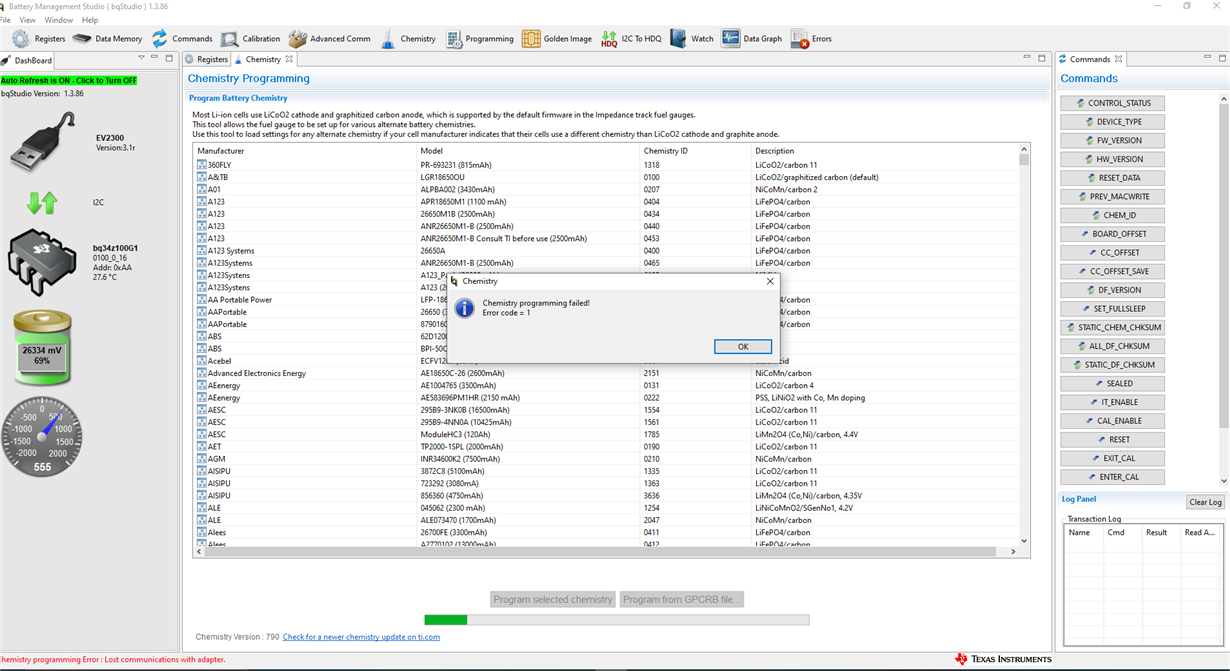

I have a file chemdat12_ID2131 that I receive for the GCPRB. but when I program the file into the gauge, I have a message error = 1. I have the battery management studio 1.3.86, the gauge is full unsealed and the voltage is good. I have program a chemistry in the list with success but the file chemistry that I receive cannot program.
I join the file chemistry
chemdat12_ID2131.zip
Ludovic
  • Hello Ludovic,
    It says you lost adaptor access. Can you try this again after restarting bqStudio? Also please use the "test" version and see if that works.
  • Hello Kang Kang,
    I have restarting bqStudio and I have the same message. with the test version I have a fault when I open bqSutdio, the log of the default is join
    Best Regards

  • Hello Ludovic,
    Are you able to re-install bqStudio by doing these instructions.
    1. Uninstall everything
    2. Delete the C:\ti folder containing BatteryManagementStudio
    3. Install bqStudio test version
    Can you also attach your GPCRB file to this e2e. I will see if the file works for my end?
  • Hi Kang Kang,
    I have uninstall and reinstall, the bqStudio works properly. I have the same problem for load the GPCRB. I join the GPCRB in this zip.8244.chemdat12_ID2131.zip
    Ludovic
  • Is the error code still showing as 1?
  • Yes, It's always 1
  • Kang Kang,
    Did you successfully load the GPCRB file I attached?
    I will be back at my post as of 2 June to test the proposition that you give me.
    Ludovic
  • Hi Ludovic,
    GPCRB programming requires that the chemistry ID that is in the gauge should match the GPCRB file. It looks like this is for ID 2131.
    Can you try programming Chemistry ID 2131 first and then try programming the GPCRB file?
  • Hi Shirish,
    I have programmind the ID 2131 then the GPCRB file but I have always the error = 1 when I try to program the GPCRB file.
    Ludovic
    Do you have any solutions for me? It becomes urgent.
    Ludovic
    with a gpcrb file from another battery, I can program the gpcrb file. I tried to recreate the gpcrb file but still have the error code = 1 when I program the file. I think the creation of the file is hurting.
    Have you a soluce?
    Ludovic
  • hello,
    I tried with the evaluation board, and the original firmware, I can’t load the GPCRB file. while with a GPCRB file from another project, the load is done well. do you have a track to unlock me?
    Ludovic
  • Do you have another EV2300/EV2400 that you can try with?
    I have already use another EV2300 and I have always the error code = 1.
    Ludovic
  • Thanks Ludovic. I wonder if the GPCRB website has changed the format of the file. Was the GPCRB file for the other successful project created recently or before the failure was seen?
  • Hi Ludovic,
    I see that you are using bqStudio v1.3.86
    Please try using the latest version. I am told there was a bug fix for a similar issue.
    Latest version is available here https://www.ti.com/tool/download/BQSTUDIO-TEST
  • Hi Shirish,
    Kang Kang already asked me to try this version of bqstudio, but I always got the same result (error code = 1).
    Ludovic
  • Hi Shirish,
    I don't have a other recent project, the last other project is one year ago and I don't have problem with the update GPCRB's file.
    Ludovic
  • The issue cannot be reproduced. Please try a fresh installation of bqStudio v1.3.101. Delete c:\ti\Battery Management Studio and install again.
    If that does not help, then we take this offline to debug.
  • Hi Shirish,
    I have refresh the installation of bqstudio v1.3.101 after deleted c:\ti\Battery Management Studio. The default is always present (error code = 1).
    is it possible that the EV2300 would be the problem (the firmware of the EV2300 is V3.2r)
    Ludovic
  • I think you mean EV2300 V3.1r
    We do not know of any issues with that version. And i think you tried with other EV2300. I will PM you.
    After generate the GPCRB, the download is succelfully.
    Thanks for your assistance.
