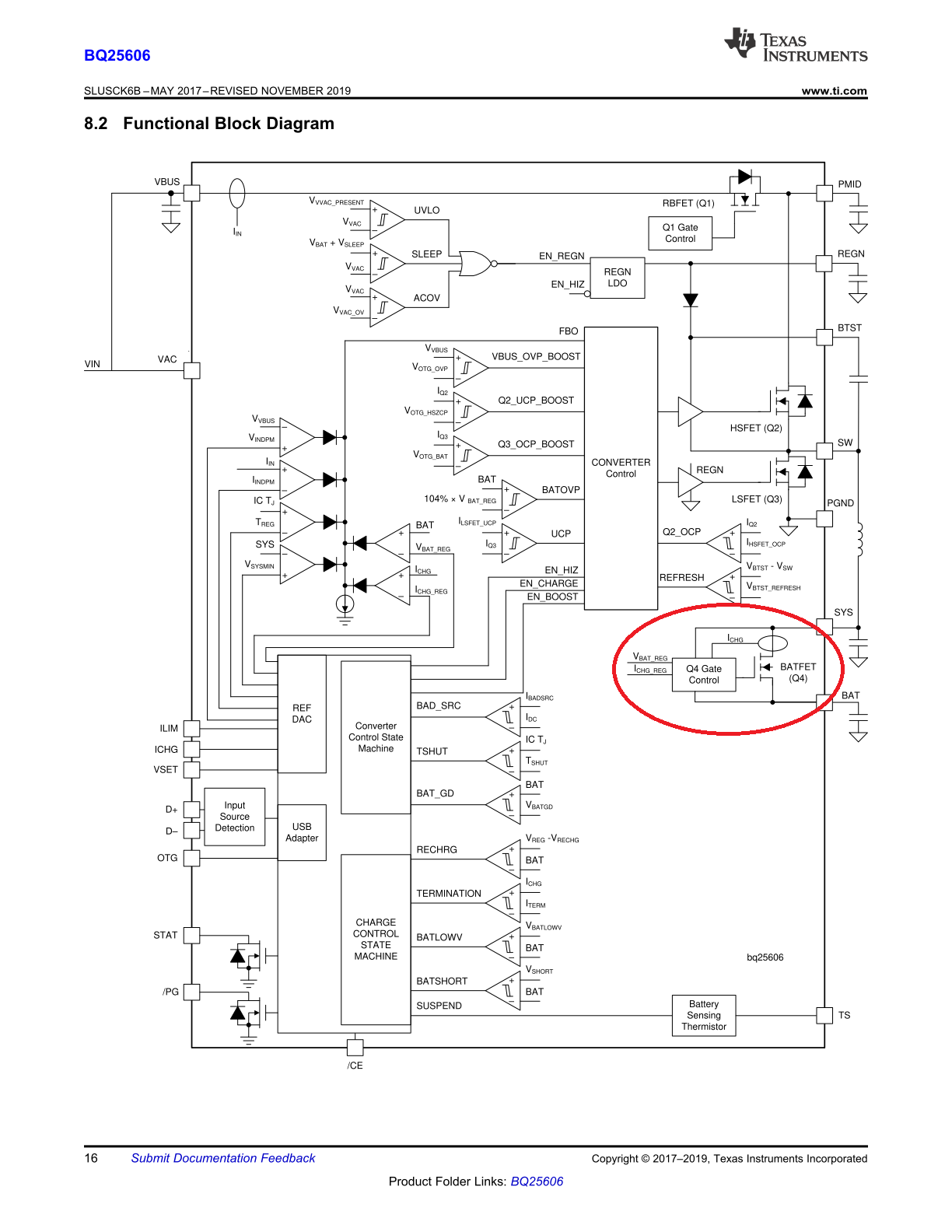

2. when CE pin is high(charging disable), is there's any leakage current from battery to VSYS?
per my assume is no , but I'm not sure if this is correct , do we have back to back MOS or diode to block the reverse current or prevent leaking current ? please kindly check , thanks!
