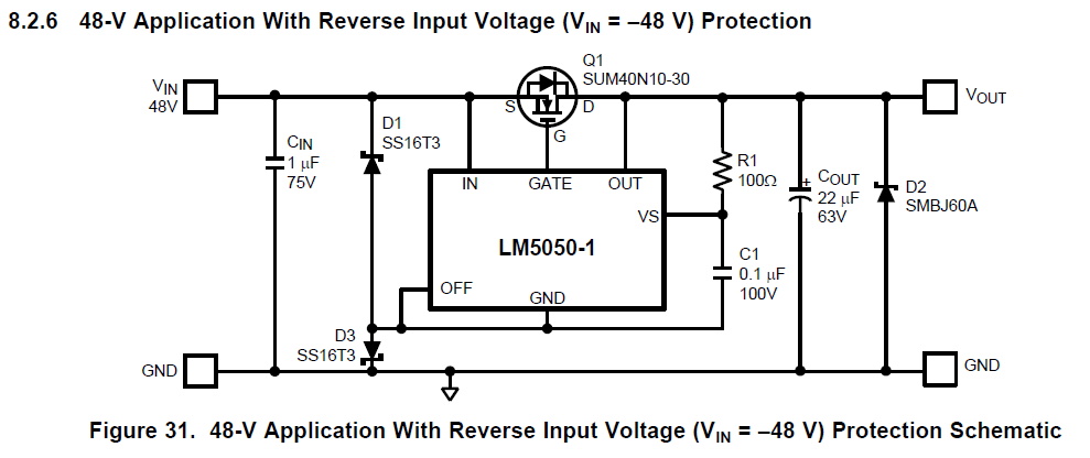

Hello.
I would like to use the LM74700-Q1 as a reverse polarity protection device in an application where the input DC voltage can be up to 60V.
However, my problem is finding a suitable TVS to protect the device (max i/p voltage of LM74700-Q1 = +/-65V). Obviously, we need the TVS breakdown voltage Vbr to be >= 60V but then this gives a clamping voltage of approx. 98V.
This clamping voltage is beyond the 65V absolute maximum rating for the LM74700-Q1.
My question is - Can the LM74700-Q1 survive "transients" up to 98V of defined duration e.g IEC610004-5 8/20us?
