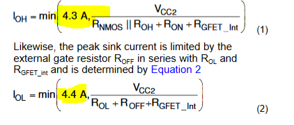

    If you are instead asking how to find out if a certain configuration ( gate resistor + FET) will exceed the drive current rating of ISO5852S, there is a simple way to estimate shown in the below Technote.
    Technote on IOH/IOL currents
    In the equations below, the highlighted values should be changed to the Peak/max values for ISO5852S from the datasheet. Thermal also should be calculated. Could be under the peak drive current limits but still exceeding temperature
    Please let me know if you have any further questions.
