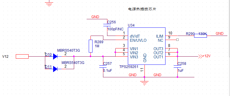

We are using TPS259261  in our product.
Input Voltage is 12V, and normal load is 1A.
Cout=660uF: we have special purpose for using such big capacitor.
There is no external Cdv/dt.
We've performed power on/off test with 30pcs of product, and found that  10 pcs of TPS259261 were damaged.
Need your support for this issue, what can we do next?

  • Hi Robin,
    The efuse has inbuilt thermal protection and it can protect itself during over current, output short circuit and startup conditions.
    When the efuse is turned OFF, there is a sudden drop in current i.e. high di/dt. Inductance in the input path can cause over voltages at the input which are much higher than the Abs Max rating of the device. This is the most common reason for failure of efuse devices. This can be avoided by using a suitable TVS at the input. Similarly -ve voltages can be generated at the output due to inductance in the output path. A schottky diode is needed at the output to clamp -ve voltages.
    As mentioned earlier you can try using a dvdt cap to reduce the inrush current during startup with a huge cap. The key here would be to startup with no load.

  • Please also help to check our sch.

  • Hi Robin,
    The IC will protect itself as long as the device is operated under Abs Max Rating of the device.
    Most of the efuse failures we see are because of over voltages generated at Input during turn on and during fast-trip conditions due to inductance in the input path. In your schematic, I see there is no TVS at the input to clamp these over voltages.
    Do you have inductance in the input path in your test setup ? Can you please check the maximum input voltage during turn ON and fast-trip conditions like output short circuit ?

    • Is the schematic shared above your final schematic ? Do you have rough estimate of input and output inductance ?
      • If  there is any significant inductance in the output path, there should be an Schottky diode at the output to clamp for the -ve voltages that can be generated during fast-trip events.
        • No, there i no significant  inductance in the out path.  But however, we have ever  observed  Cout caps failure(shorted).
