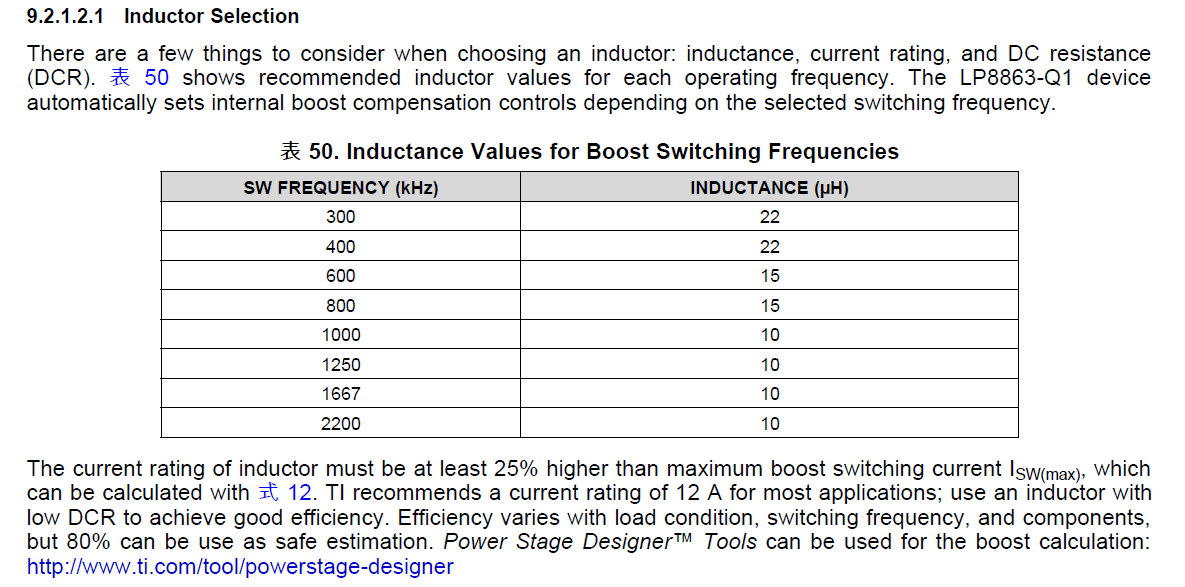

I am considering using the LP8863-Q1 device.
The circuit specifications are as follows.
I would like to ask you about the current value of the inductor.
Looking at the data sheet, the recommended inductor current is 12A.
Why do you recommend 12A?
Since I want to make the circuit small, is it possible to use an inductor with a small current value?
(specification)
Topology: SEPIC
VIN: 24V
LED strings configuration: 6strings, 2LEDS series
(Since VLED = 3V, VOUT becomes 6V)
LED string current: 100mA
