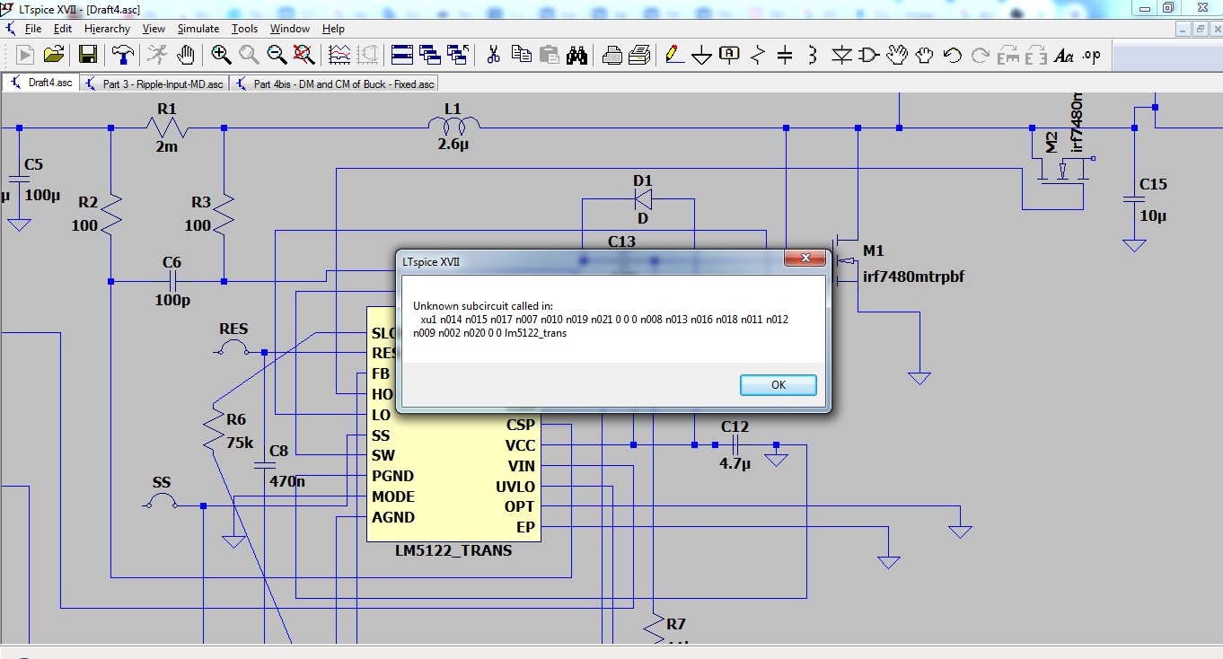

How can I investigate conductive electromagnetic interference levels with TINA-TI? I tried to test this in LTSpice, but got this error:
How to remove this error or conduct these tests in tina.
Hi Alex,
Thank you for considering the LM5122. Sorry we do not support LTSpice. You should be able to simulate in TINA with the model at the following link:
https://www.ti.com/lit/tsc/snvm495
You can modify the model to your own design, and simulate it by checking the input ripple current, or ripple voltage, depending on how you measure the conducted emission.
Youhao Xi, Applications Engineering
Hi Alex,
In order to run the frequency analysis, you will need to use the average-model of the LM5122. Please refer to this thread for background:
https://e2e.ti.com/support/tools/sim-hw-system-design/f/234/t/709571
