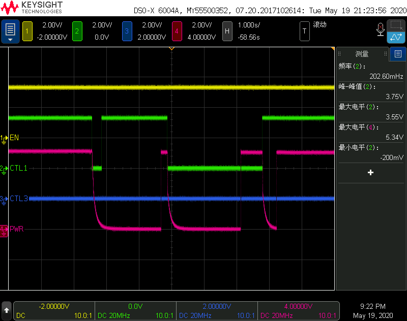

My customer reported an issue that the PC system mode (MS/S3/S0) is not stable possibly due to the USB port feature.

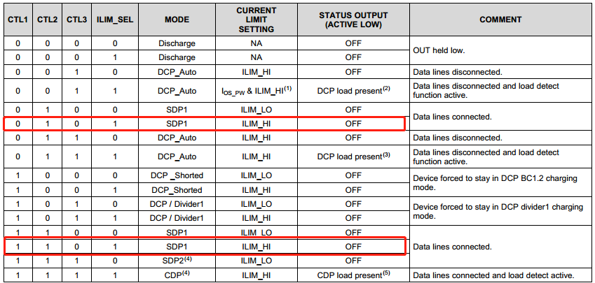

As they measure the waveforms, only CTL1 is toggling while seems the mode for 2546 keeps at SDP1:
Customer pulled CTL2 and ILIM2 to 5V and control the CTL1 and CTL3.
Seems changing the CTL1 will lead to a Vbus discharge although the mode is not actually switched. Is this an expected behavior and what is the reason for this discharge.
I'm checking with customer why a CTL1 toggling will happen while I need your help to confirm whether the Vbus discharge make sense here.
