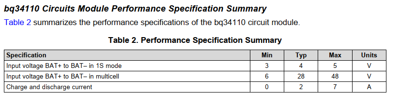

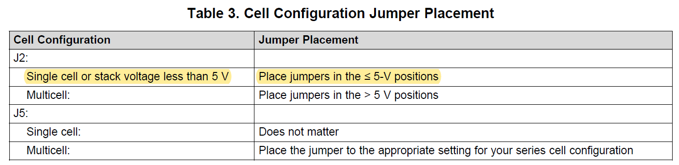

dear
In Specification, the voltage ranges of Input voltage BAT+ to bat-in 1S mode and Input voltage BAT+ to bat-in multicell are 3-5v and 6-48v, respectively. Is it feasible if the voltage range of multiple voltages is 3-5v?
dear
