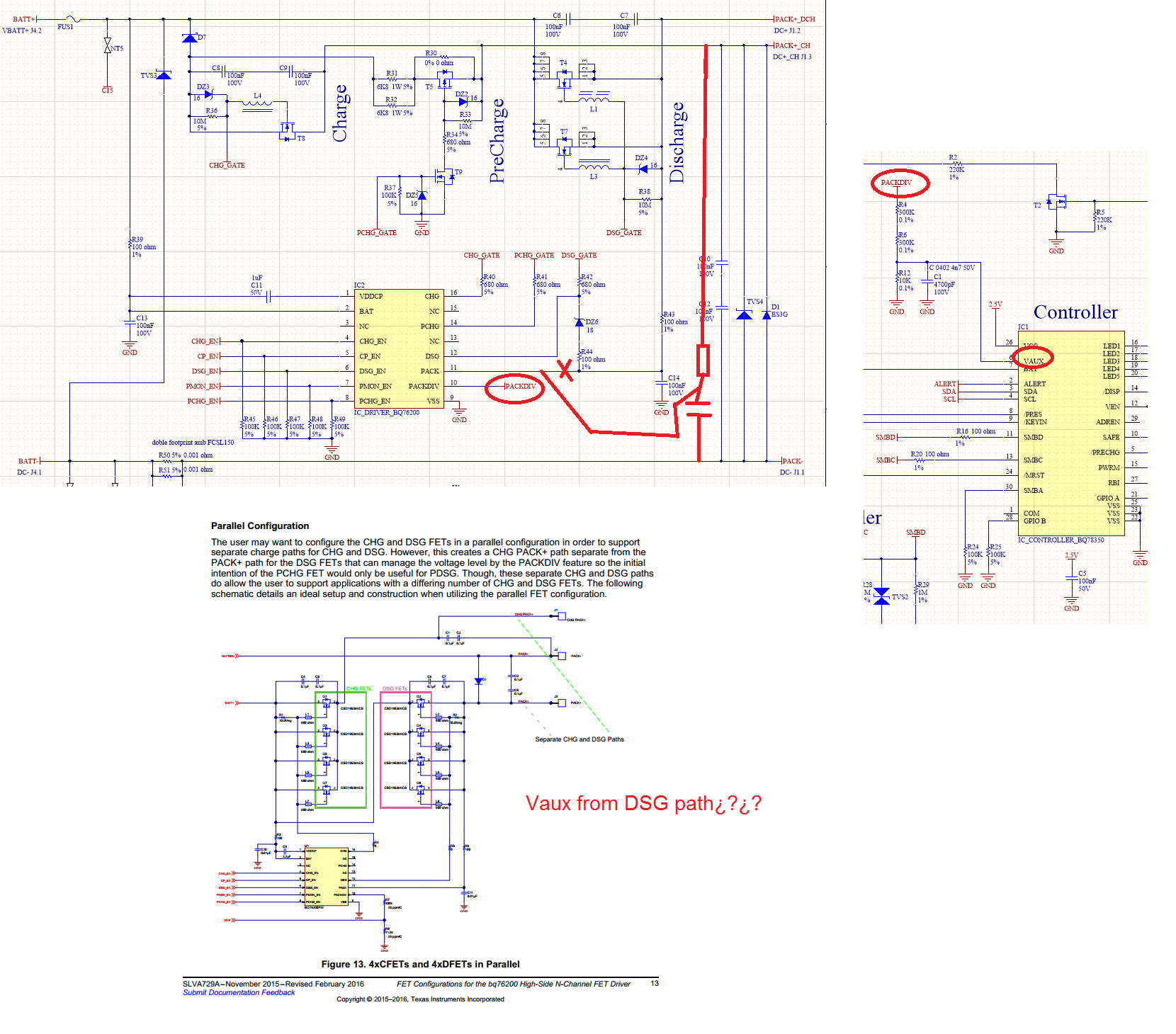

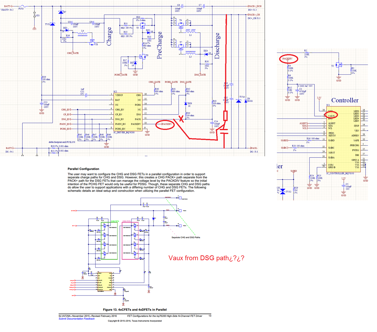

    I have based my design with the SLVA729A and there, the Vaux is linked to the DSG path?¿?¿
    In my opinion this is a nonsense in terms to recovery errors. You agree?
    Please have a look to my schematic and my proposal in red. What do you think?
    To recovery the errors from Vaux, the Vaux pin have to be link to CHG path. You agree?
    thanks
  • Hi Albert,
    The BQ78350 does not support parallel FET paths. It only is programmed for series FETs. See this thread for a more detailed explanation: https://e2e.ti.com/support/power-management/f/196/t/664995
    This thread also explains the difficulty of having only the Vaux pin since it can monitor only one of the PACK+ pins for recovery. VAux can be used as a recovery option for both over-votlage protections and for over-current in discharge protection.
    Matt

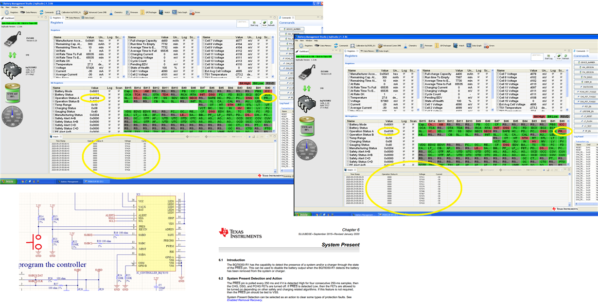

    Nevertheless I think that I can work with a parallel FETs because the pack will work in different systems when is under charge or discharge. There are two equipments the charger and the load. And in both of them, works with a host so if any fault is detected the process will be terminated and reported and the to the user. What do you think?

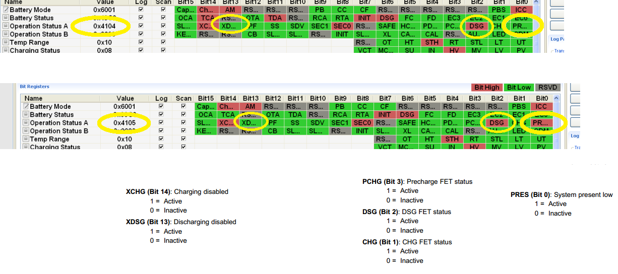

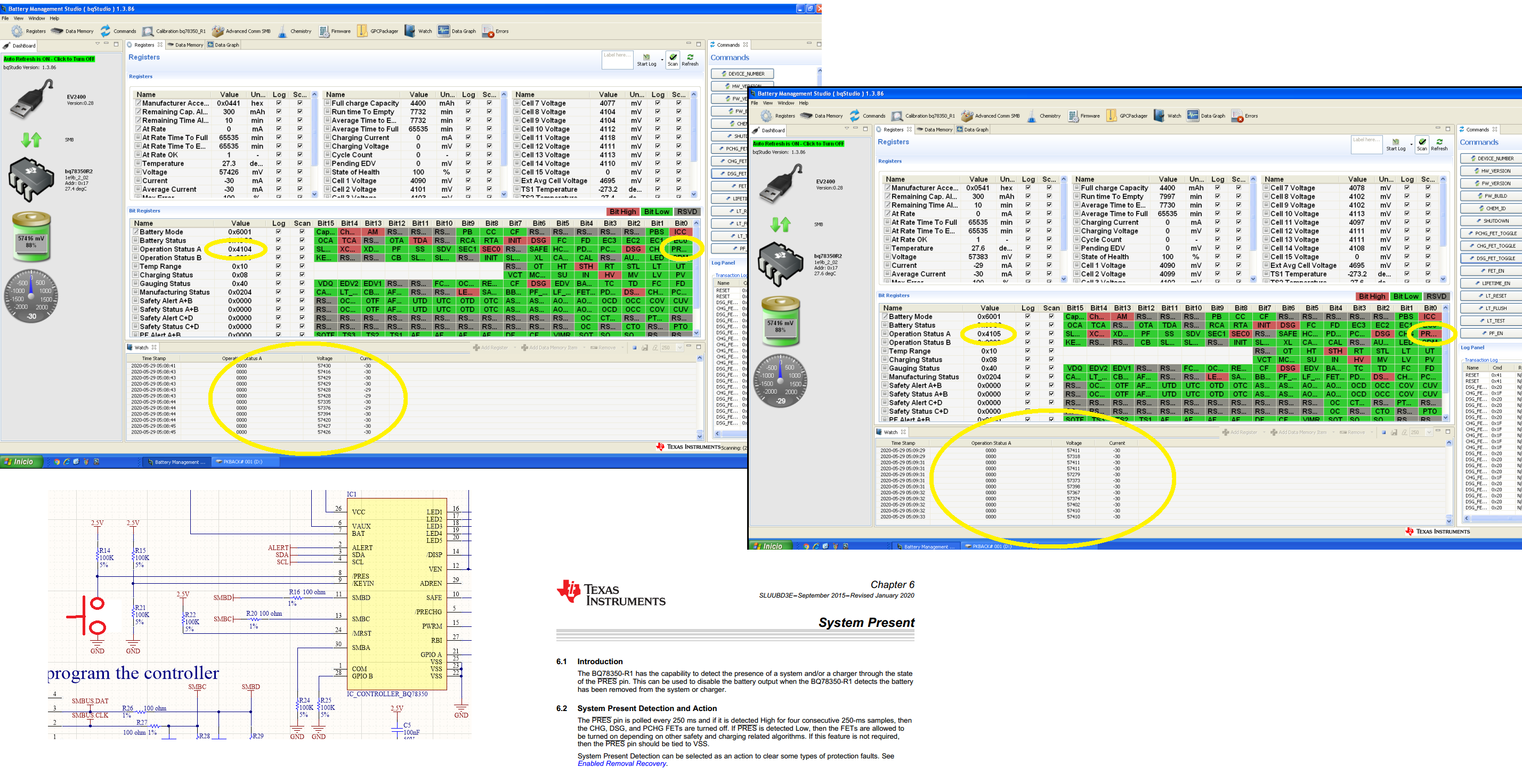

    Let me come back to PRES pin. I'm trying to work with it. The idea is really easy, if the pack is assembled into the system, then the CHG and DSG are operative; otherwise are NOT operative.
    I'm doing some test to check this expected behavior and I don't why; but doesn't work. Probably my fault.
    On the PRES pin I have a 100kohms pullup; and a switch to VSS.
    -->The bqStudio report the PRES bit set to 1 or 0 (according to the switch) BUT in BOTH cases the current is -30mA (witch means 300mA on discharging). SO DOESN'T CUT THE PATH!!!!
    WHY? Maybe some EEPROM parameter has to be set; but the DS doesn't show anything regarding parameters, seems that is just the PRES pin status.
    In addition, Why the BQStudio show the  on "Bit Registers" windows 0x4104 or 0x4105 (depending to the PRES pin detection); AND on the "Watch" window is always set to 0?
    Thanks a lot .

  • Hi Matt,
    thanks.
    Regarding the watch window, If you take note is enough for me. Let's forget it.
    About the xDSG and xCHG bits. Have a look to the picture attach.
    I was trying a discharge process with -300mA, in this case:
    -> XDSG=green=bit low=Discharging disable set to inactive. (Which means DSG active.)
    -> DSG=red=bit high=DSG FET STATUS set to Active.
    Finally you can see that the BQStudio detects the PRES pin (with a external switch) set to 0 and 1. In both cases the previous bits ARE THE SAME!!!!
    What do you think? Do you want some oscilloscope measurement?
    Do you think that the Series/paralel FET configurations has something to do? (In this test the CHG was unconnected).
    thanks a lot

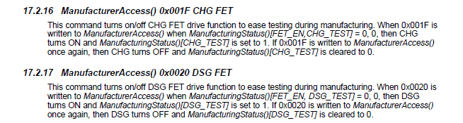

  • Hi Albert,
    This is strange. I would expect the DSG bit to go low in this case. Can you capture a log file from BQStudio and send it along with your data flash settings (click on Export on the Data Memory screen to save a .gg.csv file)?
    Matt
  • Hi Matt,
    Attach the log and .gg.csv files.
    I'm going to try with your starter kit. If you need more info let me know.
    thanks a lot.

  • Hi Matt,
    I have done the test with your Starter Kit BQ76940EVM.
    With and without the jumper on the PRES pin, the BQstudio detects with green and red, BUT is discharging all the time!!!!!
    Attach the log and the gg.csv.parameters.
    In addition the PRES pin voltage oscilloscope measurement, WITHOUT external jumper, just the internal pull up.
    With jumper is obviously 0V.
    thanks

  • Hi Albert,
    When PRES is connected to VSS, the FETs should be allowed to turn on, otherwise they should be disabled. I just tried on an EVM with your data flash settings and it works properly for me. If the jumper is populated (PRES to VSS), then both FETs are on (XDSG, XCHG both are zero). When I remove the jumper, the FETs are disabled (XDSG, XCHG = 1).
    However, after looking back at your previous screen captures, I noticed something interesting. It looks like you have executed the CHG_FET_TOGGLE and DSG_FET_TOGGLE commands (instead of the FET_ENABLE command which is the way we recommend to turn on the FETs). These commands are for testing purposes. I tried these and they are able to toggle the FETs regardless of the state of the PRES pin.
    I recommend testing again using the FET_ENABLE command to turn on the FETs.
    Matt
  • Hi Matt,
    You were right, as excepted.
    The PRES pin works. The idea is manage the BMS with the FET EN command. With the DSG FET TOGGLE is a manufacturer access, and doesn't mater the pres pin state, the FET is always ON.
    Unfortunately I had a 100K resistor pull down on PRES pin and that, wasn't produce a "good" 0V to the device. With 100 ohms works fine.
    SO... has been my fail. Sorry.
    Bravo for you, and bravo for TI.

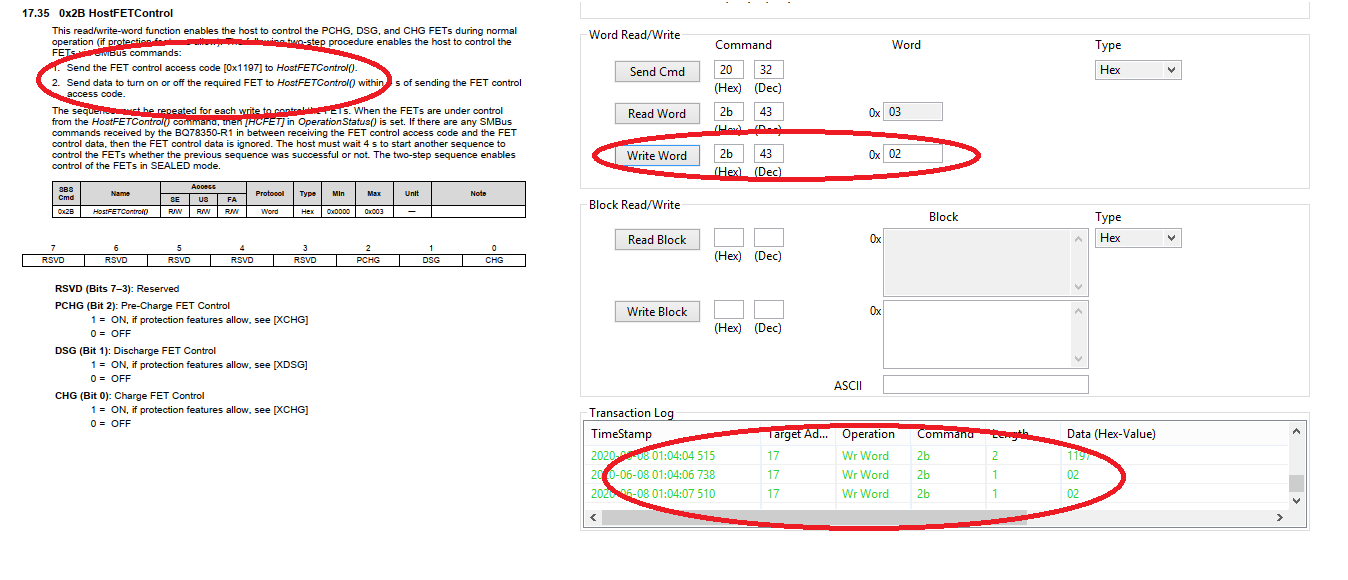

  • Matt,
    Just the last thing:
    I'm trying to update the FET state (with PRES pin low) with the command 0x2B HostFETControl.
    I know that i have to send 0x1197 first, and after the new status required. All within 4 seconds.
    But the DSG and CHG doesn't change; I if make after a read access they are set to 0x00. Why?
    It should RUN with the bqStudio tool: "Advance Comm SMB", shouldn't it? Maybe I'm using this tool wrongly.
    thanks
  • Hi Albert,
    These commands can be tricky to execute in BQStudio. I think it may be necessary to disable anything that might be communicating with the SMBus (turn off the Dashboard by clicking on the green banner in the upper left corner, turn off 'Scan' in the Register screen) since any SMBus commands received between the FET commands will cause the FET commands to be ignored.
    The 4s timing is sometimes challenging to meet using the Advanced Comm SMB screen. It looks like your commands are correct though.
    Matt
  • Hi Matt,
    You are right, as usual.
    It's working, stooping all the communications. AS LONG AS the FET_EN is set previously to high with the "ManufacturerAccess() 0x0022 FET Control"
    I'm not sure if this flag could be erase autonomously (I mean by the TI built in firmware) with a reset command, or maybe with a warning, alert, even a permanent fail. So I have to assert a way to set this FET_EN flag by my customer. And seems that the only way is accessing by a ManufacturerAccess.
    So now the question is:
    Beside the "ManufacturerAccess() 0x0022 FET Control"; there is other way to set the FET_EN flag?
    Thanks a lot.
  • Hi Albert,
    I think one solution may be to program the [FET_EN] bit in the Mfg Status Init data flash register. (See section 12.1.1 of the TRM for the description). This will enable the FETs by default after a reset command.
    Matt
  • Hi Matt,
    Works.
    thanks a lot
