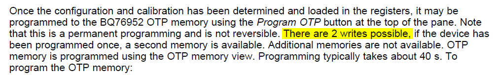

In the sluuc33 document I have read, that I am able to programm the OTP memory for two times:
How can I check how often I have programmed the OTP or if there is a OTP Programming left?

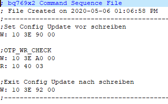

I have tried to use the OTP_WR_CHECK Subcommand (0x00A0) with following *.fs-file:

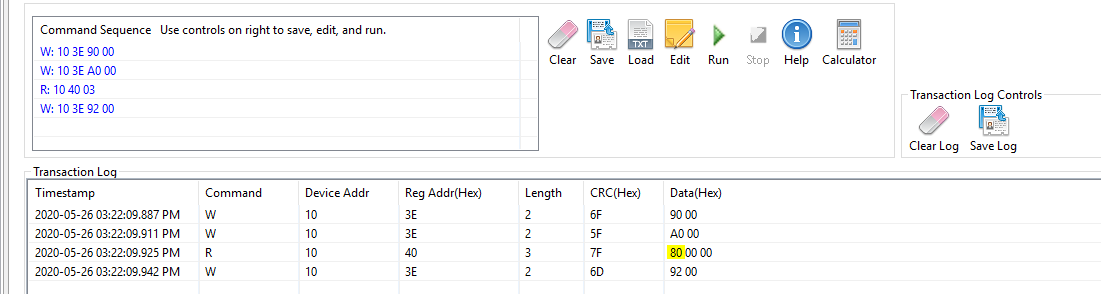

In response I receive the following:
If I check the datasheet it means I can write the OTP memory, is it right?
With this device, I know I wrote the OTP twice. So a further OTP writting should not be possible, isn't it?

    See the BQ76952 data sheet https://www.ti.com/document-viewer/BQ76952/datasheet/device-memory-t5345357-6#t5345357-6 for a description of the OTP configuration.  There are 2 writes allowed to a  bit, and 8 writes total due to the checksum storage.
    OTP is blank initially (all 0x00).  Say a parameter was changed from 0 to 6 and written to OTP setting bits 1 and 2 of that location.
    A second write could change that parameter to a 7 by addiitonally setting bit 0.
    A third write could change that parameter to a 5 by using the XOR for bit 1.
    A change to 0xF additionally setting bit 3, or a change to 4 could be allowed using the XOR for bit 0, but a change back to 6 would not be allowed since the XOR was already set for bit 1
    Yes, the "80" in your read should indicate the checks have passed and the selected configuration write was possible.
