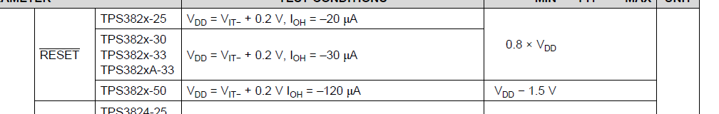

Hi Team,
Customer is using RESET(push-pull) pin to output. Do you know what is the output current capability of RESET pin? How much output current will pull RESET pin to low?
Thanks!
-Wenhao

Hi Wenhao,
The max output current is +/5 mA as seen in Absolute Maximum Ratings (section 7.1)
Abhinav.
