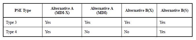

    3. If the 4pair port is designed to support type 4, you have to follow the below polarity (MDI-X and B(S)) to connect the channels to the RJ45 connector.
