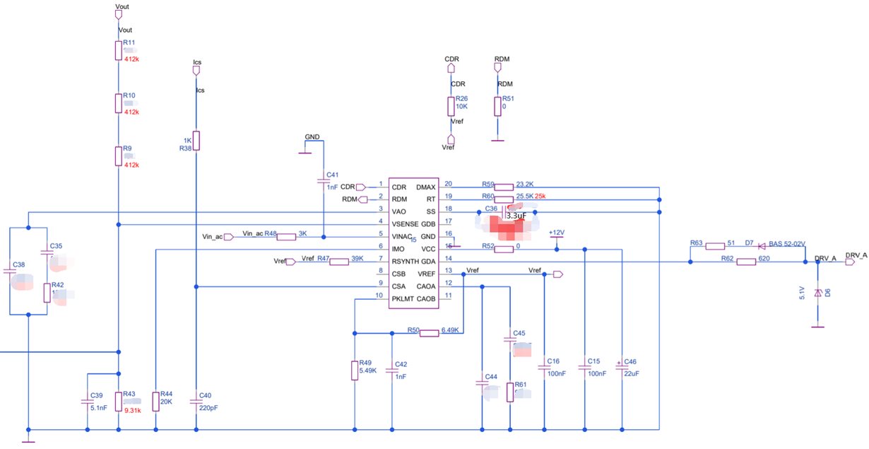

I am using UCC28070A designing an single phase pfc (~400Vdc output),
The schematic related to this controller is as follows:

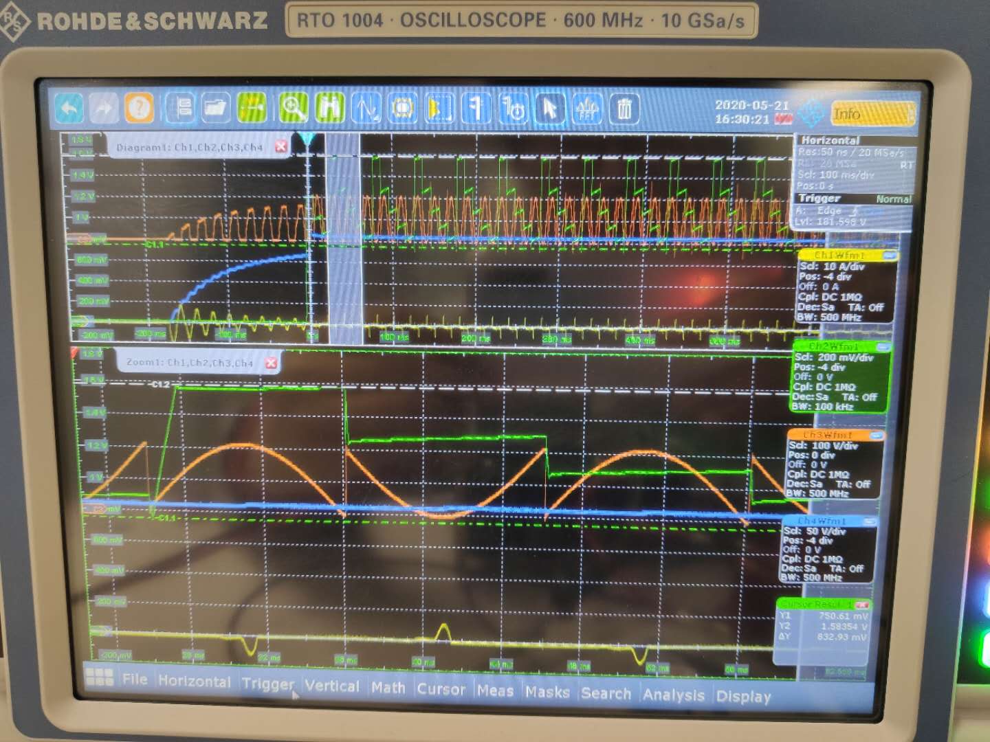

I tested it, and the result is, while +dc or -dc input, in the range from 120Vdc~380Vdc, it works well both light load and full load.
But when I switched to AC input condition, it doesn't work.
The waveform at ss pin I think is abnormal which is as follows:
Test condition: 150Vac@50Hz     0.2A Load;
Blue: pfc output voltage;                 Green: ss pin voltage;               Red: you can think of it as the 50Hz input AC voltage although actually it's not;              Yellow: input ac current;
You can see every time Vss(voltage at ss pin) reaches Vsense(I calculated and found that it equals to VSENSE when Vss starting to decrease), it starts to decrease a little at every ac zero-cross point until it reaches 0.75V, then re-start.......... No even one switching event had happened.......
While in dc input condition, everything is right.

  • Hello Jankel,
    You need to attach the complete schematic with component values used.
    Also you should use the Excel calculator tool and attach the results so that your design requirements are known.
    The embedded image you posted does not have enough information to answer your question.
    John
