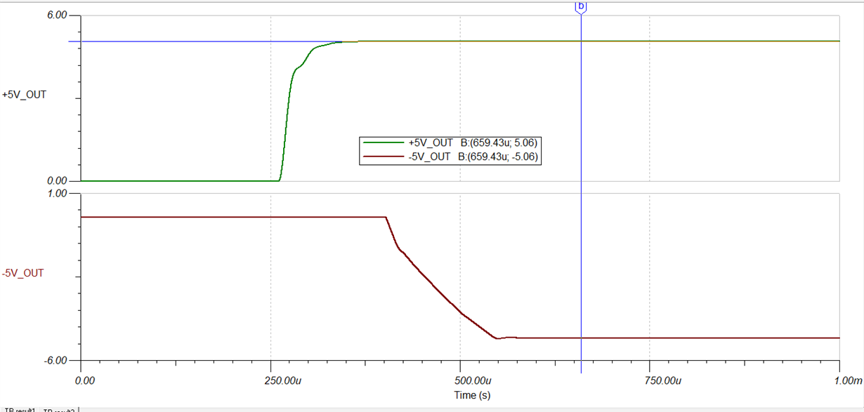

I am using LM27762 power module for generation of +/-5V supply from 5.5V input.
Without load i am getting response +/- 5.3V approx but with load( ie AD8337) , i am not getting  negative response.
I am getting +5.38V for positive out put but not getting response for negative output.
Please review my design & Let me know where i am doing wrong.

  • Hi Febin,
    LM27762 is designed in WEBENCH® Tools & response captured are as follow:
    i am getting proper response for +/-70 mA load which is as follow:
    But while doing simulation for same circuit using TINA with considering same load, i am getting  very low value like 8mV for -5 v output.
    but for +5V out put getting proper response of +5.05V( when input is +5.5V).
    Please verify whether it's Unencrypted PSpice Transient Model (Rev. B) is rightly coded or not as i imported this file into tina to make my design.
    If possible please run it's simulation for +/-5V output to power any op amp(which can take current under limit).
    you can use my design for verification:

  • Hi Febin,
    Thanks for your response.
    Without Load condition,  i am getting proper response ie =/-5V  but when i am providing load, in that case -5V is not coming.
    Please find the file attached which i am using with Load condition.2020_May_29_Chain_SIM_LM27762__autosave_200525_16_32.TSC
    Please also find response of LM27762 with Load condition to power AD8337 & LMH6553:
    How ever without load condition
    , LM27762 is responding proper:
    In both cases, i am using the modified file of LM27762 , given by you.
    please see my attached file(2020_May_29_Chain_SIM_LM27762) with load condition & prescribe the solution for LM27762 for load condition.

  • Hi Shivakant,
    Here is the updated version of the simulation file. A few changes were done and now the output of LM27762 is as expected.
    - Transient analysis with “Calculate Operating Point” checked
    - It looks like VEE(-5V) output of LM27762 is getting loaded by AD8337 and LMH6553. Hence added a buffer at the output.
    LM27762_updated_V2_updated.TSC
    Please check and let me know if you need further support.
    Febin

  • Hi Febin,
    yes, i simulated the model & now getting proper response.
    thanks for support!!!
