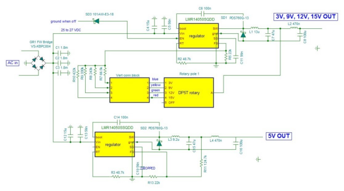

I am building a dual hobbyist power supply with two LMR14050s, one for a fixed 5 volt, the other for a switchable 3V, 9V, 12V, and 15V (schematic attached.)   I have run into a few problems, mostly my own doing that were rectified, but now have one that has me baffled.  For the first time I applied loads to the output:   a 10 ohm resistor on the 5V and 50 ohms on the selected 15 volt output.  (My intention was to measure the heat sink temperature rises.)  With the load attached the output voltages dropped:  to a few mV from 4.99V for the 5V output, and to about 45mV from 15.12V for the 15 volt output .  When the loads were removed the output voltages returned to spec.  I went through this process about five times to prove I wasn't dreaming.   Any ideas why????

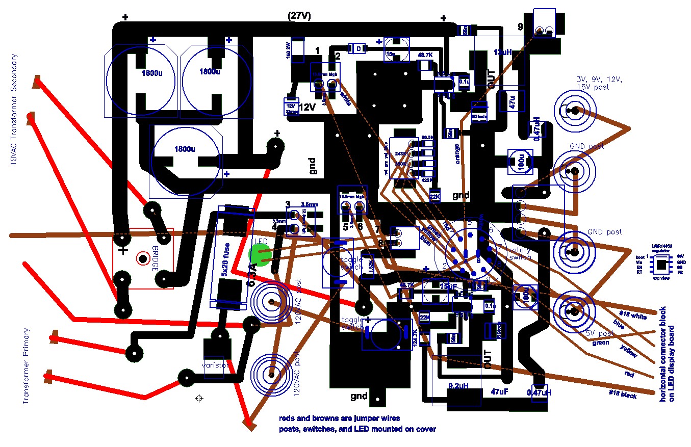

    Please attach your layout and components part numbers, let's check the trace width and components ratings first. Thanks.
  • OK.  This might be a duplicate post.
    What are the red and brown traces? Are they PCB traces? If so, they are to narrow, please use much wider traces especially power in/out ones.
  • The red and brown lines are jumper wires, brown above board and red below board.  All traces and pads are black.  Blues are component outlines and notes.
    Could you please lower the output current and test it again to see how heavy the current that will cause a output drop? Also it looks too many jumpers will cause noise in circuit, could you please remove all unrelated jumper and test it again? Thanks.
  • I made a little more accurate measurements (though they are still rough because of the gross margins in the potentiometer) of the 3V, 9V, 12V and 15V outputs.  All maintained their voltage out until the load dropped to 50 ohms to 250 ohms or so at which point the output voltages dropped precipitiously.  I suspect the actual cutoff load is different for the different voltages but I can't measure them that closely. This says 100mA to 300mA is the highest current the regulator will put out.
    I can't remove the jumpers and keep the circuit working.  But in reading more about layouts of switching regulators in TI's application note, one thing bothers me in the jumper wire category:  To switch between voltages there is a jumper from the output to the rotary switch mounted on the box cover that runs right over the output inductor,  Then there are four jumpers from the rotary switch to the four FB top resistors which are placed very near the FB pin.  Each of these jumpers are 22 gauge and about six inches in length.  Your application note says this is not a good layout.. There is very little that can be changed other than shortening the jumpers to maybe three inches.  I can also wrap shielding around the jumpers.  What do you think?
    OK, it looks the long wire of FB couples noise when the load is heavy. I don't recommend to use a shield because it not easy to find a good shielding ground, just shorten the trace please.
