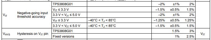

I'm confused about the VHYS spec.
The typical value VIT is 0.405V, so I can get the range of VIT which is 0.405V*(1-2%) to  0.405V*(1+2%) from the table of ds.
The question:
How to calculate the accuracy of VHYS ?
Is the unit 'VIT' of VHYS in the table based on the typical value of VIT which is ‘0.405V’ ? Or the range 0.405V*(1-2%) to 0.405V*(1+2%) ?
