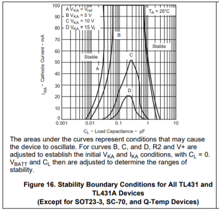

Could you please provide stability boundary conditions for load capacitance under VKA=3.3V and all temp range?
On the datasheet, we can find the following figure on VKA=Vref or 5.0V and Ta=25C.  But my customer requests the figure under his condition (VKA=3.3V and all temp range).  Please support us.  He wants to use this to decide load capacitance.
Thanks and best regards,
M.HATTORI.
  • Hi M.Hattori,
    We do not have that information available. I would use the VKA = VREF fine as it will be conservative.
    That graph on the datasheet is typical and represents 0 degree phase margin. I would choose a capacitor that is 1/2 to a full decade away from the boundary due to lot/lot variations and temperature deviations.
