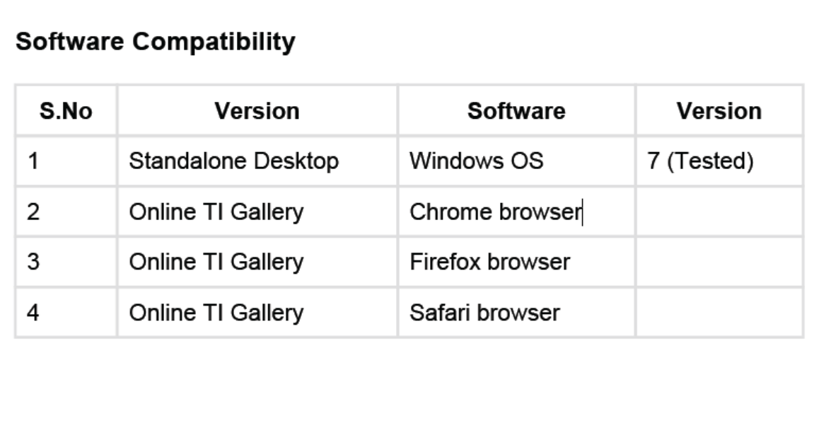

  • Got it.
    I suggest you install desktop version if you have download it successfully. By the way, have you install gcruntime at the same time?
    Below is the requirement for your computor.
