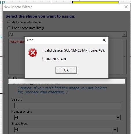

Downloaded both TPS70950 models and the give me an error when creating the macro.
Any ideas?

Hi Steve,
The error you are getting is from the encrypted model.
To import a model into TINA you will want the unencrypted model.
Please try the unencrypted model and if you have any errors, reply back and let us know.
- Stephen
Thanks Stephen,
I thought that was the one I tried. I had downloaded them both and apparently used the same one twice.
Steve
