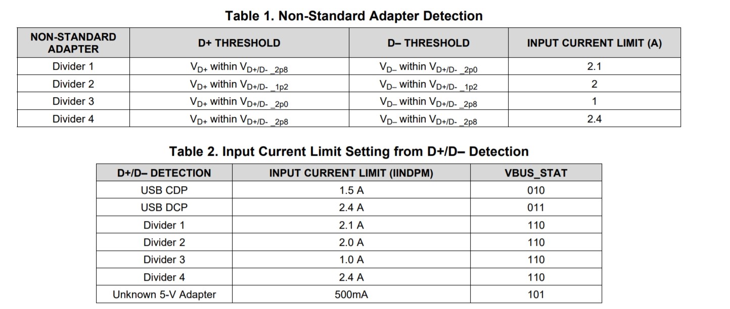

BQ25611D: When testing the charger, BQ25611 said it supports four non-stardard adapters. May I ask how to test and verify whether four non-stardard adapters are supported

  • Hi, one way to test it is to use real adapters or USB ports to supply the charger BQ25611D. After the D+/D- detection, the IINDPM register will be updated accordingly and the input current limits can be read from the register.   Divider 1, 3, 4 are Apple 2.1A, 1A and 2.4A adapters. Divider 2 is Samsung adapter.
