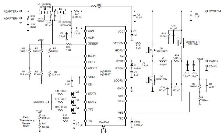

Dear experts, please refer to below figure. I set the fast-charging current to 50mA and set precharge current to 10mA. R7 is 100K ohm, R8 is 43.2K ohm, R5 is 100K ohm, R6 is 43.2K ohm and RSR is 1 ohm. L1 is 6.8uH. The ADAPTER+ is 16.8V and PACK+ is 11V(3 *Li iron battery). The real fast-charging current is about 12mA. The fast-charging current will depent on PACK+ voltage. When I increase the PACK+ voltage, the  fast-charging current will reduce.  When I reduce the PACK+ voltage, the fast-charging current will increase. Could you give me some suggestion how to achieve the 50mA fast-charging current and 10mA precharge current. Thanks.

    50mA fast charge current, and 10mA precharge current are extremely low current values for this part. Setting 1ohm sense resistor is extremely high, and has not been validated with such a configuration, as this part was intended to fast charge, as opposed to trickle charge at such low current.
    I would not recommend this part for 10mA precharge/termination current.

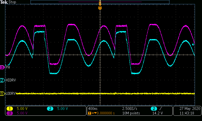

    Can you capture PH, HIDRV, LODRV on scope capture? This way we can identify if part is in DCM or CCM, to further debug, although it is highly unlikely that this part can achieve 50mA fast charge, and 10mA precharge/termination with accuracy.
  • Dear Kedar, I set the fast charge current to 80mA, R7 is 100K ohm, R8 is 93.1Kohm and RSR is 1 ohm. L1 is 6.8uH.The ADAPTER+ is 16.8V and PACK+ is 11V(3 *Li iron battery). The real fast-charging current is about 37mA. Please refer to below figure. Thanks.
  • Dear Kedar,
    I have updated the figure of PH, HIDRV and LODRV. I change the fast-charging current to 80mA . R7 is 100K ohm, R8 is 93.1K ohm and RSR is 1 ohm. L1 is 6.8uH. The ADAPTER+ is 16.8V and PACK+ is 11V(3 *Li iron battery). The real fast-charging current is still less than 80mA(about half of 80mA). Could you give some suggestion? Thanks.
  • Hi Jason,
    As the charge current sensing is so low, the converter is operating in DCM, to prevent negative inductor current, and turns off the LSFET. This is why the PH(switch node) waveform looks like this, as for the rest of the falling inductor cycle, both FETs are off. In DCM there is less current accuracy, so achieving high charge current accuracy at such low currents with this part is not possible. This part was not designed to operate at such low charge currents (trickle charge) and is meant to accurately fast charge the battery.
    One option is to try a higher inductance value for the inductor, which results in lower inductor current ripple, which might help the internal current sense accuracy by reducing valley of the inductor current.
