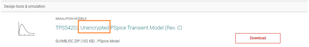

Hi team,
What's the problem and how to solve it? Is the pspice model right?  Thanks!
Br,
Nison
  • Former Member
    0 Former Member
    Hi Nison,
    This model is designed for Pspice simulator, and not for Simplis.
    I am not surprised for the failure of translating it to Simplis simulator.
    Thanks.
