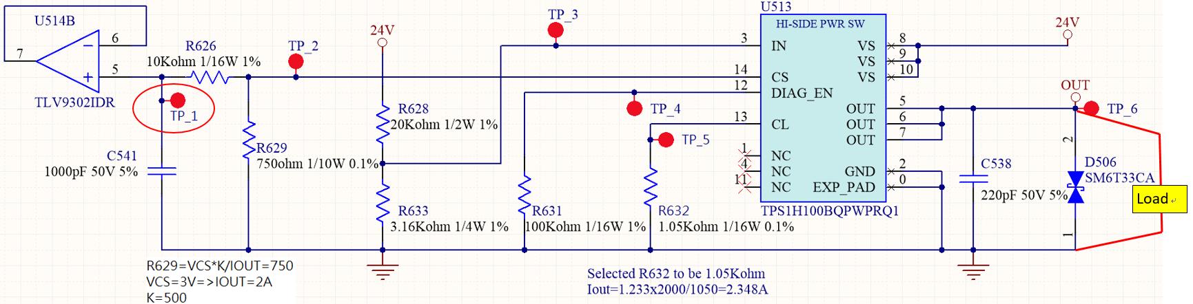

When I do function test for my sample board.
The TPS1H100BQPWPRQ1 current limite funtion was correct, when current reach limit level IC will off output.
But the current sense analog output(CS) wasn't feedback all the time.
 what reason?
