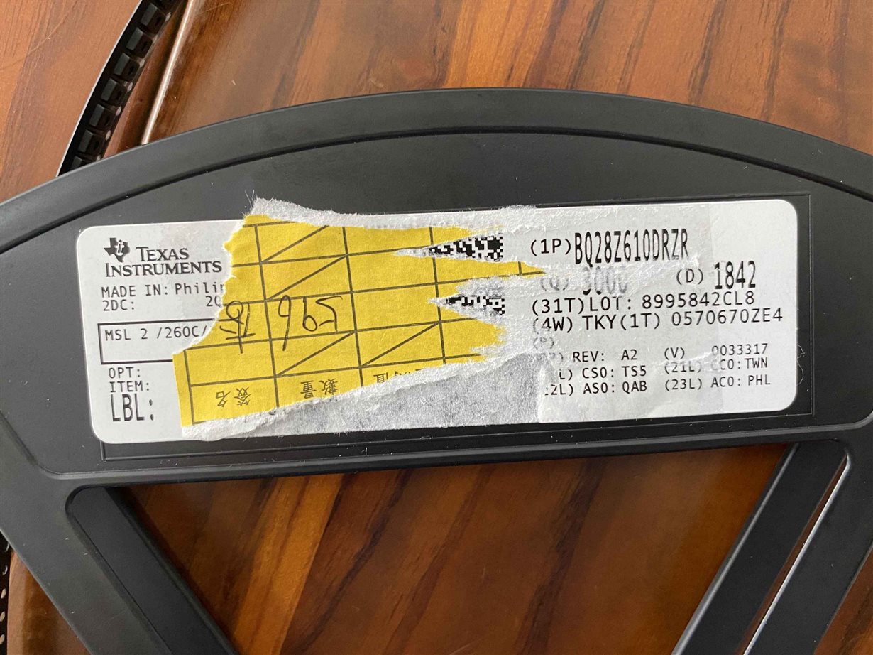

BQ28Z610: How can we understand which is the ROM version from the label on the reel?
Part Number: BQ28Z610
Other Parts Discussed in Thread: , BQSTUDIO
recently we have faced a big issue with our outsourcer: we ask to assembly a batch of boards and we provide him the list of part number, (original part number, the whole code stated into the data sheet)  and he assembled the board.
Later we flashed all board with the .srec file originated by the 0.20 ROM version.
Well, all the batch did not work and later I discovered that the ROM of the BQ28Z610 was in the version 0.16.
The PN on the reel was exactly the same BQ28Z610DRZR .... other inscriptions I do not know, it seems no one refers to the ROM version....
Attached the picture of the label on the reel.
To avoid similar even remote incidents in future, how can I instruct the buyer about ROM version? It is a way to understand that information from the labelling of the reels?

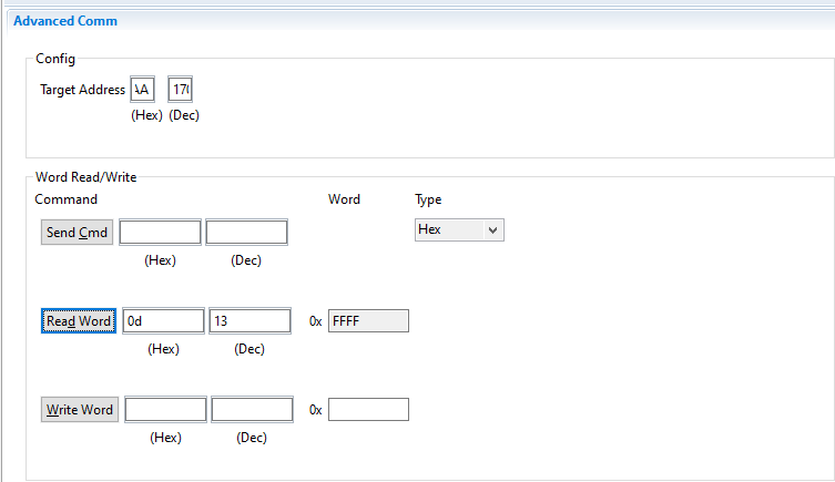

  • The reply is 0xFFFF, look at the picture.
    and this is the picture when bqStudio starts:
    But, is the ROM version written somewhere in the label onto the reel?
    I suppose to know which version is, now, what I want is to avoid similar problems in the future..... thanks anyway for helping me!
    Maurizio

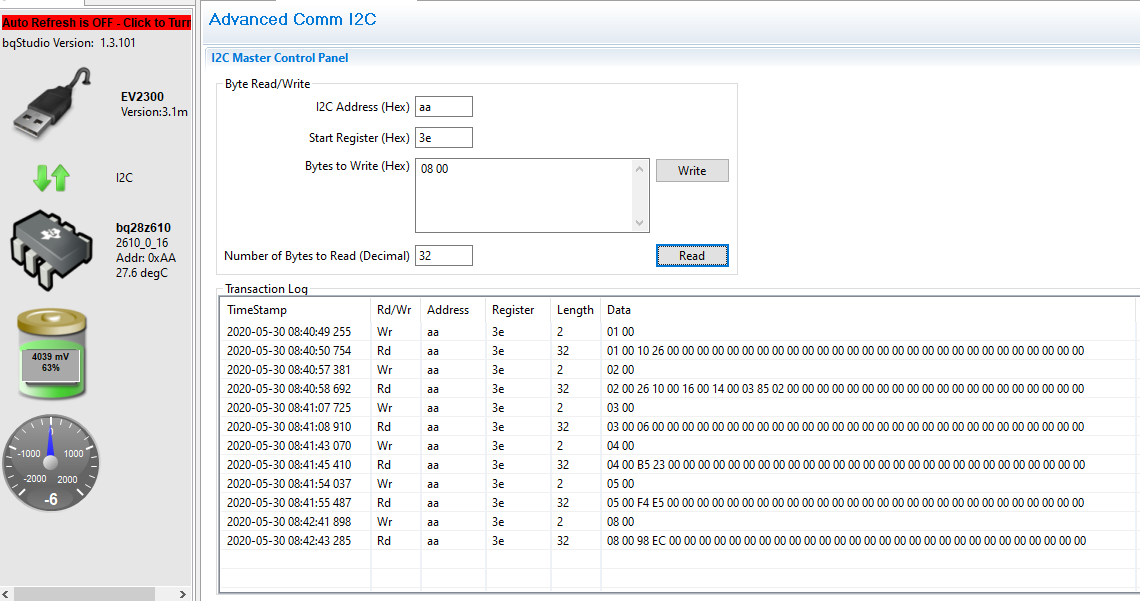

  • Hi Andy,
    attached the replies at the commands sent directly by AdvCom.
    I am sure you can find what they mean .... hoping it helps more...
    it is odd at my eyes that 0xEC98 for ChemID, assumed the ChemID command has not changed with different version.....
    Maurizio

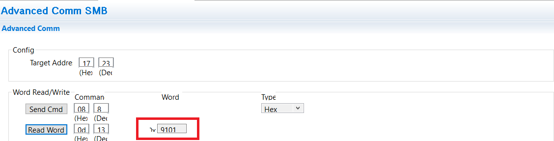

  • The v0.16 is the firmware revision.
    Please make sure you follow exactly the instructions highlighted below.
    1. Go to Advanced Comm I2C screen in bqStudio
    2. Put the part in ROM mode by sending 0x00 0F to register 0x00.
    3. Switch the communication to SMBus and restart bqStudio, and select a part like bq40z50 which uses SMBus.
    4. Go to Advanced Comm SMB screen and Read Word 0xD. (This function should return the ROM version).
    5. Tell us the result.
    You should see something like what the screenshot shows below.
    Andy

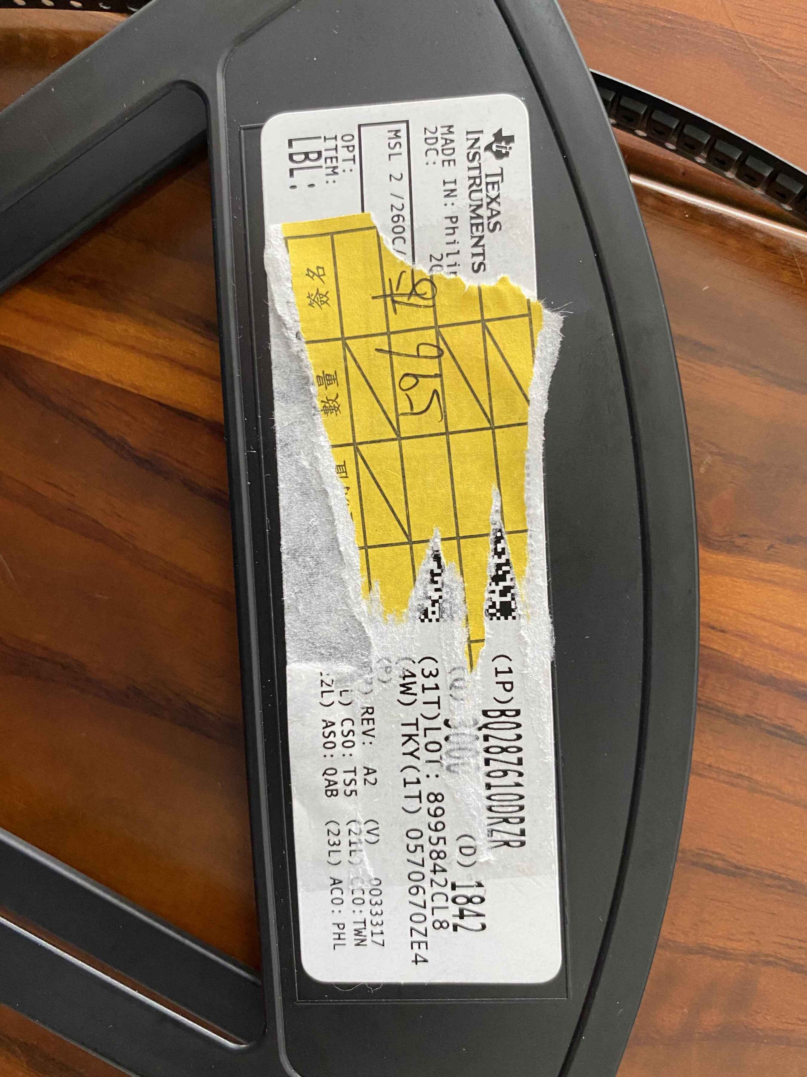

  • Hi Maurizio,
    For your question "To avoid similar even remote incidents in future, how can I instruct the buyer about ROM version? It is a way to understand that information from the labelling of the reels?", the ROM version is indicated by the "Rev: A2" on the reel package. If you were to order BQ28z610-R1, you would see "Rev: A3" on the reel.
    Rushi
  • Thanks,
    but to be honest, the reel of BQ28Z610 I have with the rom 0x9100 has 'Rev:A2' over the reel, like you can see by the picture attached at the post #1.
    Then, according what Rushi said, they should be OK: NO, THEY ARE NOT! The good ones to be flashed with FW 0.20 have the ROM 0x9101.
    Rushi, could it be that the BQ20Z610 equipped with FW 0.17 or 0.20 bring the Rev:A3?
    The BQ28Z610-R1 has its own code,  because there is that "-R1
    I am beginning to think that also in TI there is some confusion....
    thanks to all who are trying to help me
    Maurizio
    PS: I have checked the resolved issue box, but I was wrong, not yet finished! Please, administrator, uncheck it
  • Hi Maurizio,
    To the best of my knowledge, if "Rev: A2" is seen on the reel package,  all the bq28z610 devices should be A2 materials and they should all return the ROM version 0x9101
    I don't know what happened to the reel you got.  My suggestion is to contact whom you purchased that reel from. You should be able to ask for returns.
    Andy
