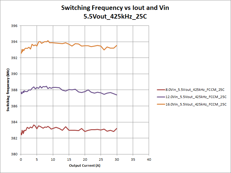

Hi TI,
please help to provide frequency curve of TPS548D22.
1. frequency vs output current
2. frequency vs output voltage
BR

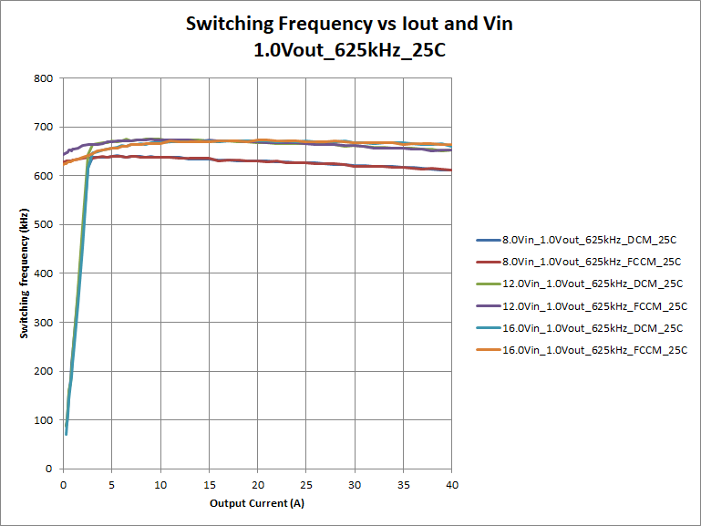

Hi TI,
BR
One more set of data I just found to help show the fsw vs Vout is below. Operating near the minimum on-time causes the fsw to start to decrease with the 0.6V output with 12-V input so data at 6-V input is also given.
| Vin = 12 V, Vout = 0.6V, Iout = 5A | Vin = 6 V, Vout = 0.6V, Iout = 5A | Vin = 12 V, Vout = 1.0V, Iout = 5A | Vin = 12V, Vout = 5.5V, Iout = 8A | |
| Set Fsw (kHz) | Fsw (kHz) | Fsw (kHz) | Fsw (kHz) | Fsw (kHz) |
| 315 | 317.7 | 301.8 | 314.0 | 290.4 |
| 425 | 428.8 | 405.0 | 428.3 | 387.8 |
| 550 | 519.1 | 509.9 | 545.1 | 486.9 |
| 650 | 581.7 | 613.4 | 658.6 | 582.6 |
| 825 | 649.9 | 767.6 | 806.2 | 725.4 |
| 875 | 883.8 | 828.7 | ||
| 1050 | 977.6 | 975.6 | ||
| 1125 | 1166.2 |
